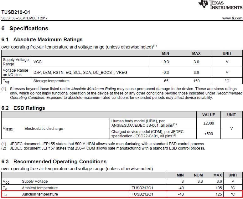

My customer asked about the junction temperature ranges of TUB211-Q1.
Because the TUSB211-Q1 didn't have the relevant data on the junction temperate in the datasheet as capture below, but the TUSB212-Q1 has that data as below.
Is it the same as TUSB212-Q1?
< TUSB211-Q1 datasheet >
< TUSB212-Q1 datasheet >
