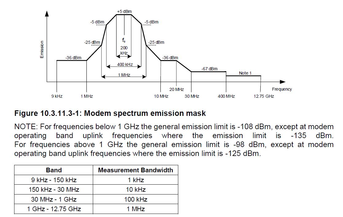

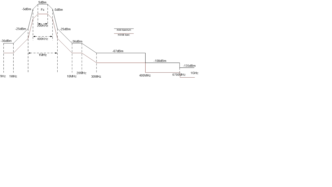

Hello
SN65HVD63 is Conforms to Proposed AISG V3.0 specification.
The emission spectrum is displayed in the datasheet up to 400Mhz.
but AISG v3.0 Request the Up to 12.75Ghz for emission spectrum.
Please let me know the emission spectrum between 400Mhz and 12.75Ghz.
and Recommend the Reference Circuit for AISG v3.0.
