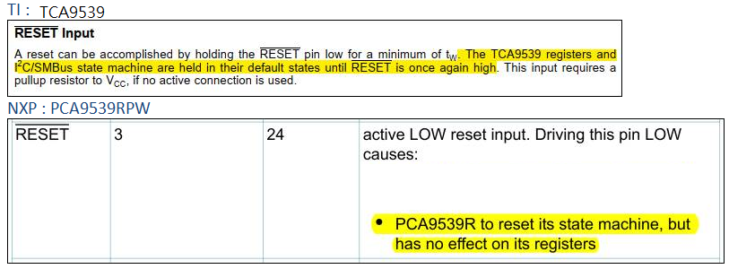

We are looking for a replacement solution for NXP PCA9539R, and which TCA9539 has same function but RESET function is different,
NXP PCA9539R: when RESET=Low, it will reset state machine but not registers,
TI TCA9539 : when RESET=Low, it will reset state machine & registers both
Do you have any suggestion parts which has same function & RESET function as NXP PCA9539R which will not reset the registers?
  • Hey Anne,
    "Do you have any suggestion parts which has same function & RESET function as NXP PCA9539R which will not reset the registers?"
    Unfortunately not, all of our I/O expanders use this reset circuitry.
