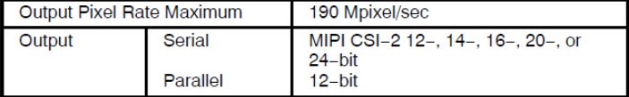

    May I confirm with you again whether the following Sensor specifications can support UB953? Thanks for kindly help~
  • Hi AJ,
    What frame rate are you planning to run at? How many bits per pixels?
    Jiashow
  • Dear Jiashow.
    Good day.
    Frame rate is 2880 x 1080 @ 60Hz.
    About how many bits per pixels? Do you want to ask the following picture? Thanks for kindly help~
  • Hi AJ,
    With your resolution and frame rate, you should be able to run MIPI CSI-2 12bit or 14bit mode.
    Jiashow
  • Dear Jiashow.
    I got it. Thanks for kindly help~
