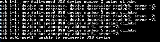

We are TUSB2046 Hub and TS3USB221 MUX/DEMUX in our custom design. We have host processor connected to Common USB port of TS3USB221. We have one device connected to Port 1 of TS3USB221. Port 2 of TS3USB221 is connected to TUSB2046 at Upstream Port and few high speed devices connected to Download stream port of TUSB2046.
We have configured the Selection input of TS3USB221 Common USB port is switched to Port 2/TUSB2046. such that the We are facing following problems:
(i) The devices connected to TUSB2046 are not getting enumeration for each power cycle.
(ii) During few power cycle, even if the device is getting enumerated, the device is not responding.
(iii) During few power cycle, TUSB2046 Hub is not getting detected at Host Processor side. And we are getting the error as mentioned in the attached image.
(iv) If the device connected to TUSB2046 is getting detected, if we switch the TS3USB221 to Port 1/Other Device and switch again to Port 2/TS3USB221, the device connected to TS3USB221 are not getting enumerated.
