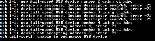

We are using TUSB2046 Hub and TS3USB221 MUX/DEMUX in our custom design. We have host processor connected to Common USB port of TS3USB221. We have one device connected to Port 1 of TS3USB221. Port 2 of TS3USB221  is connected to TUSB2046 at Upstream Port and few high speed devices connected to Download stream port of TUSB2046.
We have configured the Selection input of TS3USB221 Common USB port is switched to Port 2/TUSB2046. such that the We are facing following problems:
(i) The devices connected to TUSB2046  are not getting enumeration for each power cycle.
(ii) During few power cycle, even if the device is getting enumerated, the device is not responding.
(iii) During few power cycle, TUSB2046 Hub is not getting detected at Host Processor side. And we are getting the error as mentioned in the attached image.
(iv) If the device connected to TUSB2046 is getting detected, if we switch the  TS3USB221 to Port 1/Other Device and switch again to Port 2/TS3USB221, the device connected to TS3USB221 are not getting enumerated.

  • These errors typically indicate an electrical problem with the cable; in your case, there is probably an electrical problem between the host and the hub.
    Please show the schematic of your circuit.

  • Are the USB_OTG_D_P/N nets connected directly to the host chip? (Which one?)
    I see that there are 33 Ω resistors before the USB connector, but none in the USB_OTG_DS_P/N nets. Is this the correct circuit for your OTG controller? (When two USB chips are connected directly together, the connection must have a characteristic impedance that is equivalent to that of a USB cable connection, so it's likely that the host/hub connection is wrong.)
    The SUSPND pin might be high because the host could have decided to automatically suspend the hub when idle.

  • Sankara,
    It sounds like the problem may be that the host is not seeing a device disconnect / reconnect when the switch path is changed. Also if DP is always pulled high, the hub may enter the suspend state when it is really disconnected. Can you confirm that if the application is started with a particular path on the TS3USB221 enabled and it is not switched, the application works?
