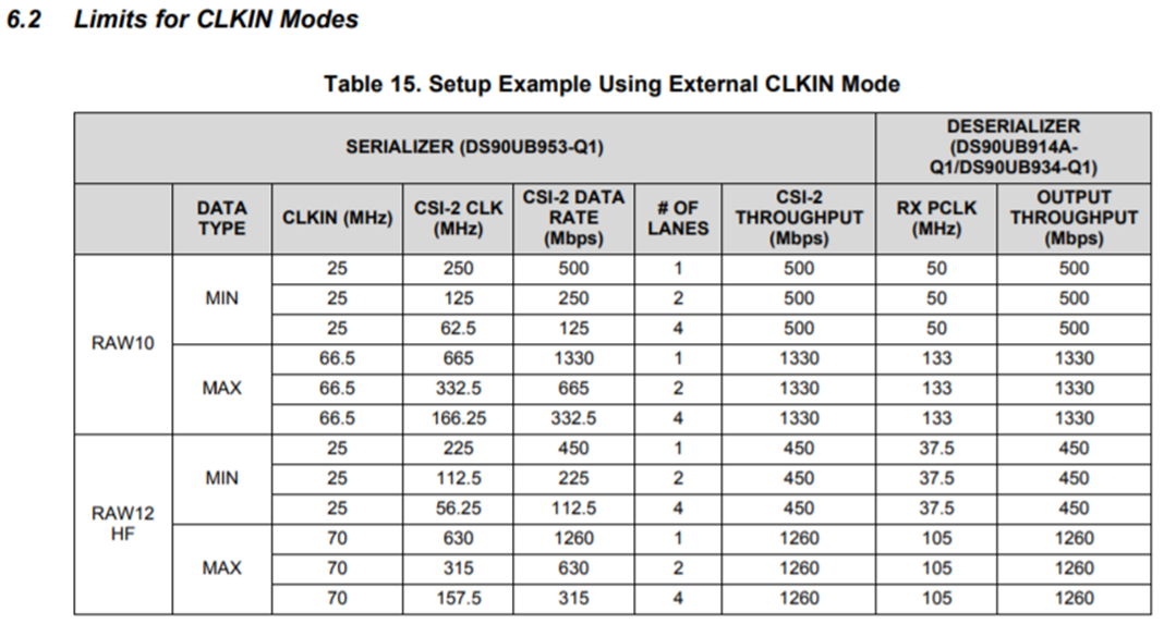

Part Number: DS90UB953-Q1
Regarding to snla270a, the maximum RX PCLK of RAW10 mode for 914A/934 is 133MHz in the table 15.
I thought maximum PCLK for 914A/934 is up to 100MHz.
Does 914A/934 actually accept PCLK up to 133MHz?

hello Hamzeh,
Thank you for reply. could you double check about 914A limitation?
Also i want to confirm if 934 can support 133MHz. I dont see the description in the 934 datasheet.
