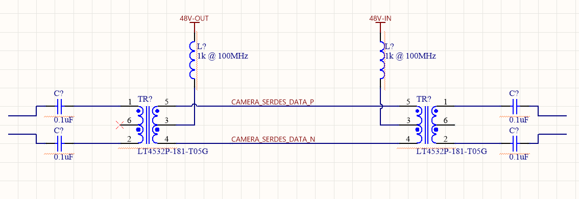

Part Number: DS90UB934-Q1
I want to use ALT4532P
The picture is an approximate scheme
I would like to know if this will work
