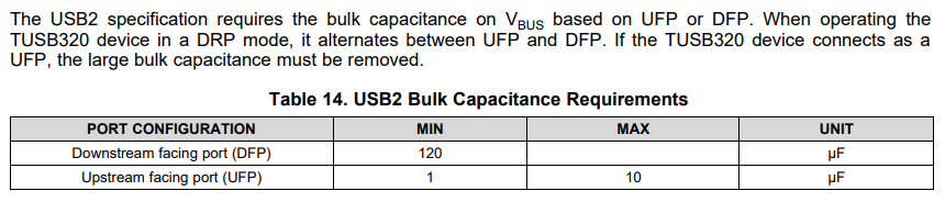

We have a question regarding TUSB320. In the datasheet, it stated,
For our use-case, the device is in DRP mode. What's TI's suggested implementation on connecting/disconnecting the bulk (120 uF) capacitor as the device switches between UFP and DFP?
BR,
Gary
