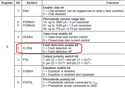

We use ONET1151L to drive Laser in optical module.It works normally when the fault enable bit FLTEN is set to 0,but the laser can not emit light when the fault enable bit FLTEN is set to 1.
We try to write 11001010,11101010,10001010 to the Register 0(0x00) of ONET1151L,the fault always exist.Then we change the value to 10000010 writen to the Register 0,the fault is removed.
Why is this happening?What else do we need to set up when the fault enable bit FLTEN is set to 1?
  • Hi Harrison,
    I believe - based on values you are using - bit 3 is always set so fault is enabled(11001010,11101010,10001010 ) until you write 10000010 - bit 3 is set to 0'b - disabling fault detection. As far as I can see, this is normal.
    To determine what caused this fault, you can try the followings:
    1). Set MONPFLT, DMONP, and DMONB to low. For example set reg 0x0A[2:0]= 000'b.
    2). Next enable FLTEN by setting reg 0x0[3]=1'b.
    3). Do you see fault trigger?
    Then you can enable MONPFLT, DMONP, and DMONB one at a time to figure out which condition caused fault.
    Regards,,nasser
