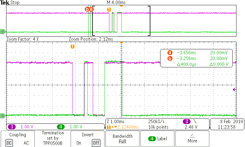

  • Hey Reif,
    For some reason I am not able to get the TXRDY to even go high when sending a byte into THR. Been stuck trying to debug this for about an hour but no avail. I'm going to ask our design team to see what the requirements are inorder to get TXRDY and RXRDY to toggle.
    -Bobby

  • Hey Reif,
    I was finally able to get TXRDY to toggle....... So it looks like there is a requirement where you must perform a read of IER (I havent tried other registers yet) and then when you send data to THR TXRDY will toggle.
    My steps:
    After initializing the registers:
                       default_IER = 0x00,
                       default_FCR = 0x00,
                       default_MCR = 0x00,
                       default_LCR = 0x07;
                       default_AFR = 0x14;
    then I read register IER (its 0x00).
    After this I send 0xAA twice again:
    IOW is purple which I use to trigger the o-scope. I see that TXRDY toggles after this. Previously without doing a read of IER, TXRDY stays latched.
    -Bobby
  • Hi Bobby,
    WOW! I would not have even guessed that! I kept scoping both the TXRDY/RXRDY lines (I have these connected to GPIO Pins on the processor as well to read them) and saw TXRDY Latched forever.
    That is a good find!
    So I'll initialize registers as follows:
    default_IER = 0x00,
    default_FCR = 0x00,
    default_MCR = 0x00,
    default_LCR = 0x07;
    default_AFR = 0x14;
    Read TXRDY
    If set, write a byte to THR
    Then read register IER = 0x00
    Then read TXRDY
    and so on until finished sending the last byte
    I'll give this a try and let you know how it works.
    Thank you Bobby,
    Reif
  • Hey Reif,
    You should probably perform the read of IER after initializing everything.
    After that I don't think you need to read it again.
    From there you should be able to perform your TXRDY check and send data.
    -Bobby

    This means that I should see nTXRDY go Inactive (High) when the 60 Byte Trigger Limit is reached right?
    From the Logic Analyzer I see nTXRDY go Inactive (High) after only 17 Bytes, then low after the other 43 Bytes have been transmitted. This happens 4 Times for 4 60 Bytes Blocks and it transmits the other 19 Bytes as well.
    The problem i am seeing is that the last 3 Bytes of the Packet are being cut off even though the LSR shows both THR and TSR are Empty. This happens every time.

    "From the Logic Analyzer I see nTXRDY go Inactive (High) after only 17 Bytes "
    Are you sure the TLR is set to 'F'? (bits3:0 = 1111?) Make sure you do a read of TLR to make sure the value you read is the value you wrote. (This register is both a write and read)
    "Any thoughts as to what I've missed?"
    It doesn't look like you've missed anything.
    How are you verifying that the last 3 bytes are not being transmitted? Are you looking at the receiver only or do you look to see if the TXA line is transmitting correctly? We should try to verify where the issue is coming from (transmission or receiving)?
    -Bobby
  • Hi Bobby,
    Yes I'm positive the TLR is set to 0x0F. I have diagnostics that read all of the TL16C752D Registers after initialization and they are indeed set correctly.
    I am looking at both TX/RX Lines as well as the nTXRDY/nRXRDY lines using my logic analyzer.
    At the end of the TX Packet the nTXRDY line stays low and the last three bytes of my packet are missing. nTXRDY never goes high until I start transmitting another packet.
    Both TXA and RXA lines are Transmitting/Receiving correctly as I can see the packets with the logic analyzer.
