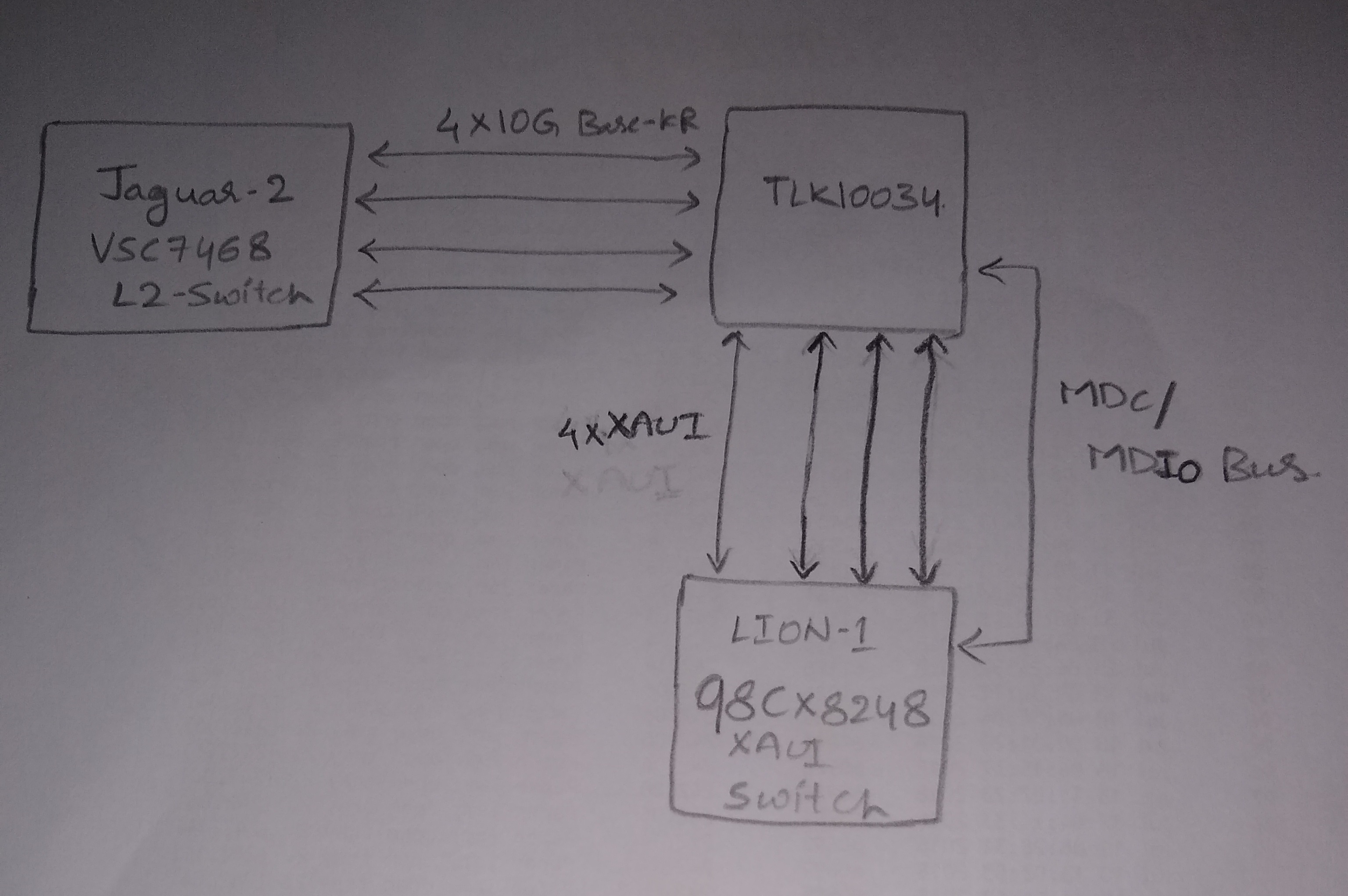

In our design we have used TLK10034 in (XAUI <-->10G Base-KR mode), 4x 10G Base-KR channels are connected to an External Switch (residing on the same PCB). 4x XAUI channels are connected to a XAUI switch. The 4x XAUI channel links are UP. But 10G Base-KR side link is not UP. Auto Negotiation is not completing with value of AN_STATUS register (0x7.0x1) toggling between 0x88 and 0xCD .The Auto Negotiation is not completed on the Link Partner side also.

    Could you help me understand your system by providing a simple block diagram? What external switch are you using ?
  • Hi Malik Barton,
    Please find the 10G Base-KR data path block diagram.

    We were able to make the link up.We have set  "KR_TRAINING_ENABLE" bit  .i.e. Bit 1 to "0"(Device Address: 0x01, Register Address: 0x0096, Value: 0x0000 , Disable 10GBASE-KR start-up protocol ).
    Then the 10G Base-KR Link started coming-up.
    Some times we may need to give data path reset .i.e. make Device Address: 0x1E, Register Address:0x000E , Value:0x0008. We have to check whether we really need to give data path reset after disabling of KR Training.
