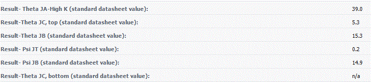

Can someone let me know the thermal resistance for TL16C754B.
Standard value for TQFP64 found online is 65 deg/W. Can this value be used.

    I wasn't able to find the thermal resistance numbers for this device in the datasheet, I assume when you say you found it as 65d/w you mean you found it through a search engine and not the datasheet.
    We have an internal system where we can run thermal simulations to get more accurate thermal numbers based on the process technology used, I'll place an order there and see if we can get you some numbers. Typical turn around time is a few days but can be as long as 2 weeks.
    I'll let you know when I have an answer for you.
    -Bobby
  • Hey Phaniendra,
    Here is the thermal data:
    -Bobby
