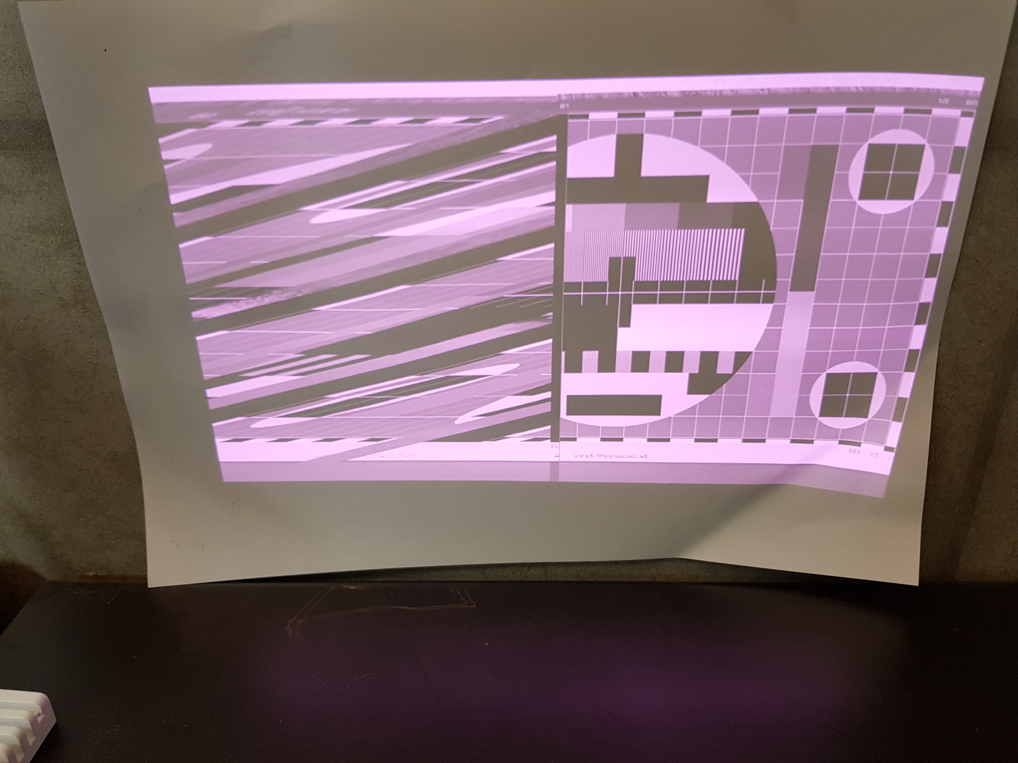

Hello!
I have designed my own PCB which is based on DLPDLCR4710EVM.
Instead of ITE6801, I used a TFP401 as a HDMI decoder not including voice.
The source of HDMI is output of desktop computer video card.
And the resolution of HDMI is a full HD of 1920 x 1080.
I have a problem interfacing the TFP401 to DLPC3439.
As the attached image, the displayed image is not good.
The half of image is normal and the other is abnormal.
I have posted about this problem as like the below link.
https://e2e.ti.com/support/dlp/f/94/t/741486
The conclusion of this post is that there is no problem interfacing DLPC3439 to DLP4710.
But I have no confidence between TFP401 and DLPC3439.
According to the TFP401 datasheet, it shows that the TFP401 supply WUXGA resolution.
What I want to know is that the TFP401 is a proper decoder for interfacing with the DLPC3439 in full HD mode.
I'd like to approach this problem in a view of TFP401.
Please, help me to solve this problem.
