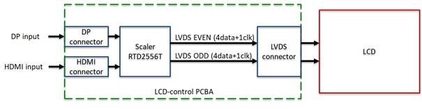

We are survey digital signage for double-sided display
Input : 1*HDMI + 1*DP + 1*DVI (option)
Output to LCD : dual LVDS (odd : 4data+1clk, even : 4data+1clk) , or eDP and Vby1.
The focus is need display two same LCD panel (1080p) at same time.
Our function block of LCD-control PCBA as below
We saw TI have application report on HDMI/DVI to LVDS/OLDI.
I think we add LVDS buffer then should be ok for use one input to diaplay two Pane, right?
So, did you have any suggest parts can suitable for our application?
