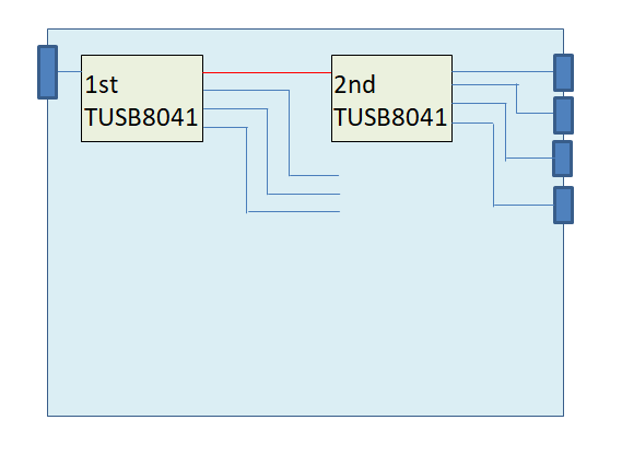

TUSB8041: Two TUSB8041s case, USB_VBUS
Genius 17925 points
Part Number: TUSB8041
When two TUSB8041s are connected as the below figure, I would like to confirm what signal should be connected to USB_VBUS pin of the 2nd TUSB.
Should PWRCTLx/BATENx be connected to  USB_VBUS pin of the 2nd TUSB?
Or should 3.3V or 1.1V hub power be connected to it? If so, what resistance value should be used in resistor divider?
