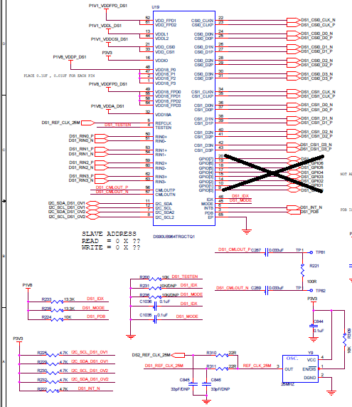

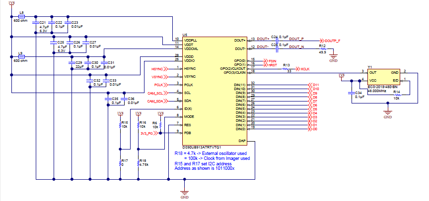

We have built  camera module using TIDA-00421 gerber from TI. We are using DS90UB964 deserialiser on our main board. Serialiser and deserialisers are connected using FPD link-III.
After image sensor and SerDes configuration we are able to see data at image sensor output (Oscilloscope probe). But we do not see data at serialiser and deserialiser output.
Since we are able to see output from image sensor we assume we are missing something in SerDes configuration.
Below are the SerDes commands used as per our requirement. Could you check and suggest if we are missing out any configuration.?
Note: Deserialiser ID(DS90UB964)- 0x30
          Serialiser ID (DS90UB913)- 0x5d

    a) Could you please upload a simple block diagram of your setup?
    b) Did you check lock status between the deserializer and serializer?
    c) Suggest you connect ALP to the deserilizer I2C port and check if you are able to see serializer as partner device in Info tab. Please upload a screen shot of the info tab. You can refer DS90UB964EVM user guide for help.
    d) Have you verified all i2c read/writes are happening without error? Please check from ALP first (either through register window or from scripting tab) that i2c access are fine.
    e) How are the 964 GPIOs connected? Pleas show a snippet of your schematic showing only 964, 913 connections.
    > we are not connecting 964 GPIO's anywhere. They are left open. Attaching the schematics for your reference.

    b) Initialize UB913 serializer next
    - make sure mode pin is configured properly
    - make sure GPIOs are configured properly according to your setup
    c) Finally initialize the image sensor registers (OV10640)

  • Bharati,
    1. Serializer GPO1 is connected to the imager reset. In addition to enabling the GPO, you should  reset the imager
    a) Set the reset pin high
    b) Set the pin low (wait for some time)
    c) Set the pin high
    Then initialize the imager. Are you initializing the imager registers? Don't have to upload imager initialization but just want to be sure you are doing it. Please double check what's the frame rate, data type, etc it is set for. Overall imager data rate (hor resolution x ver resolution x frame rate x #bits per frame x blanking overhead) must be within what 913 can support.
    2. Please double check how other GPOs are used and keep them high or low as per imager specification
