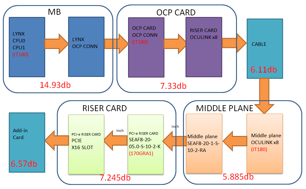

  • Hi Sir,
    Our customer is use on PCIe application, as below is Total loss topology.
    Is this not recommend using multiple DS125BR820 devices?
    Hugo
  • Hi Hugo,
    This is a long and complicated channel.  I would not usually recommend repeaters for this application.  If I needed to try to make it work I would recommend using a single DS125BR800A in each path.
    The most difficult issue to solve is the upstream path from the Add-in-Card to the CPU.  The best location for the redriver in this path is on the motherboard and it is not typical to have room for the redriver in this location.  For the downstream path the redriver would need to be on the riser card.
