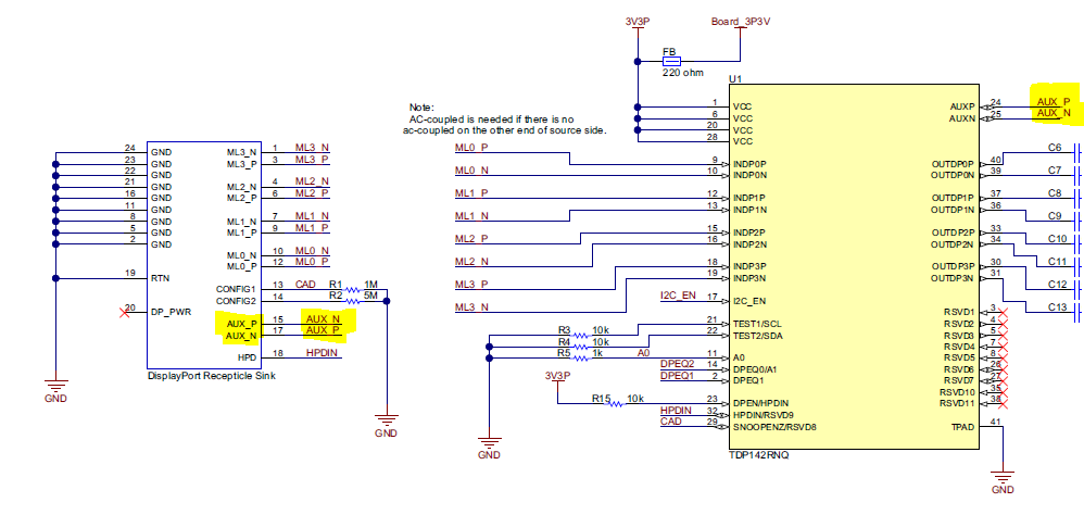

I have a question for Figure 19(P24) of TDP142 datasheet(SLLSEZ1B).
In this figure, TDP142 AUXP pin is connected to AUX_N(17) pin of the receptacle.
And TDP142 AUXN pin is connected to AUX_P(15) pin of the receptacle.
I think they are reversed. Are these connection typo?
