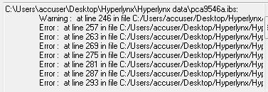

My customer would like to know how to change the SC0-pin into output status when SCL input?
We only could find the default status is NC.

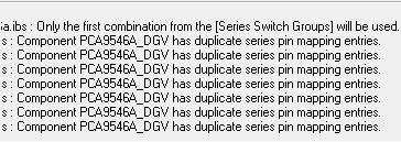

Hi Bobby,
We seem to find the problem, there are no " Series Pin Model " and " Series Switch Groups " in TCA9546A ibis model, we try to copy these information from others, it can work.
So can you share the TCA9546A's " Series Pin Model " and " Series Switch Groups " information for me?
In addition, we find the model name SC0 default setup is "NC" but it still work, shall we give it another model name? If yes, which model name should I give?
