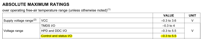

Please allow me to double check the absolute maximum ratings (AMR) for Pin #32 and #33 which are S1/SCL and S2/SDA respectively.
Our customer is facing I2C issue constantly in the market, asking us that the description is correct or not.
TMDS361B datasheet describes AMR is 5.5V, however, the internal circuit shows the pins have ESD protection diode.
Q1). Is the AMR value described in the datasheet, which is -0.3V to "5.5V", correct for these local I2Cpins ?
Q2). Can user apply signal or pull-up voltage to these pins at VCC=0V without device damage ?
Kawai
  • Q1: spec should be correct, AMR means max voltage device can tolerant.
    Q2: it may draw current when Vcc=0v, but should not damage device.

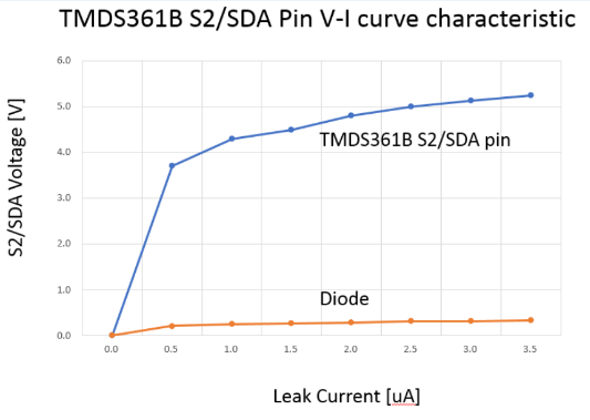

  • Hi Brian-san,
    I've checked the leak current when S2/SDA is applied without VCC power supply (VCC=0V).
    From this result, it seems there is only zenor diode between S2/SDA and GND. No ESD protection diode between S2/SDA and VCC.
    This should be the correct design for the I2C pins, because if there is ESD protection diode from S2/SDA to VCC, I2C bus woud be always pulled down when the device is not powered up.
    The data sheet might have the wrong equivalent schematic or it is only applied when used in GPIO mode.
    Thanks for your support. I'm closeing this topic.
