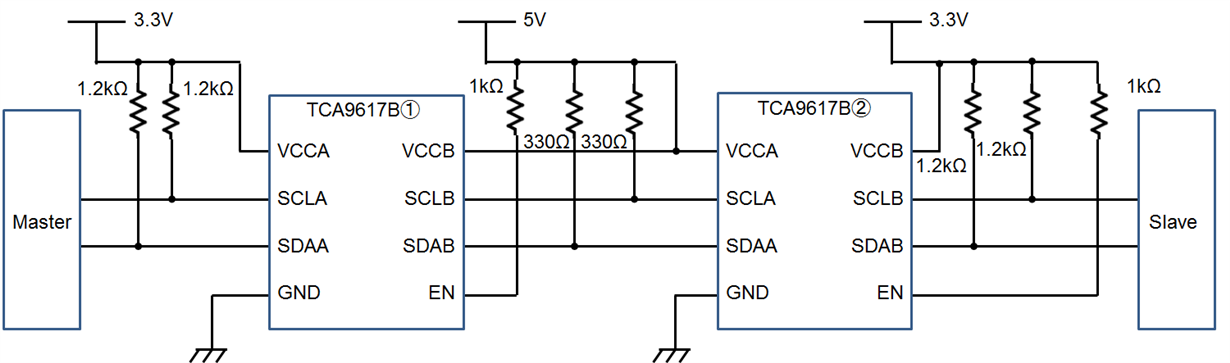

I have some question about TCA9617B.

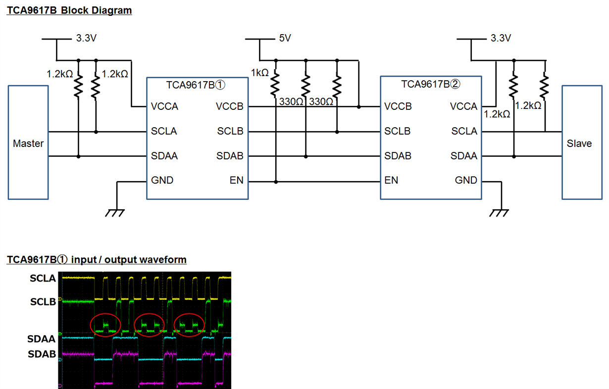

SDA will not be output correctly when used with the following configuration.
It becomes an intermediate potential like a waveform.
Is there a problem with such a configuration?
Also, do you know the cause that can be inferred from this material?
