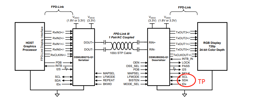

I have set the register 0xC6 to DS90UB927,but i can not get interrupt form DS90UB928.Did i need to set some register to DS90UB928 with the function of interrupt?
The INTB_IN of DS90UB928 is connect TP.
    could you pls check the INT description in UB927/UB928 d/s on how to set the INT function? pls make sure you follow up this design on register setting.

  • I have been set 0xC6 register to 0x21(reg_0xC6[5] = 1 and 0xC6[0] = 1),and i have been try to read the 0xC6 and 0xC7.i read 0xC7 and the value is 0x80 before i set 0xC6,but when i have been set 0xC6,i read 0xC7 and the value is 0x00.Whatever did i do,the INT pin is low all the time.

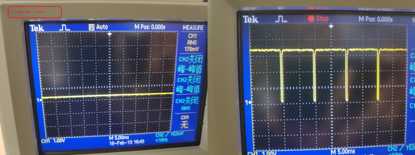

    b. measure and compare the two INTB signals in the de-ser and ser side.

  • Thanks for your reply.I measured the INTB pin whit 928 and 927,the 928 INTB is connect TP, so this is ok.but the INTB of 927 is low all the time.I don't know why.the INTB of 928 will maped to 927 when i set the 0xC6.
  • 1. check the hareware design, following TI's d/s refer. and the EVM refer. design.
    2. pls provide the test waveform and reg. setting ( whether it is complied with above request on INTB settting in d/s)?

  • The left is 927 waveform,and right is 928 waveform.
    and i set register like this:
    1._927_read_reg(client, 0x00, rbuf)                                                           ---------  0x00 -> 0x18(927 i2c address)
    2._927_write_reg(client, 0x03, rbuf[0] | 0x08)                                           ----------  0x03 -> 0xba
    3._927_read_reg(client, 0x05, rbuf)                                                            ---------  0x05 -> 0x00
    4._927_read_reg(client, 0x06, rbuf)                                                            ---------  0x06 -> 0x58(928 i2c address)
    5._927_write_reg(client, 0x07, 0xBA)                                                          ---------  0x07 -> 0xBA(TP i2c address)
    6._927_write_reg(client, 0x08, 0xBC)                                                          ---------  0x08 -> 0xBC(TP i2c alias id)
    7._927_read_reg(client, 0x0c, rbuf)                                                             ---------  0x0C -> 0x05(des id)
    8. _927_write_reg(client, 0xC2, rbuf[0] | 0x02)                                           ---------  0xC2 -> 0x82
    9._927_read_reg(client, 0xC7, rbuf)                                                            ---------  0xC7 -> 0x60
    10._927_read_reg(client, 0xC4, rbuf)                                                          ---------  0xC4 -> 0x38
    11._927_write_reg(client, 0xC6, 0x21)                                                         --------- 0xC6 -> 0x21
    12._928_write_reg(client, 0x1D, rbuf[0] | 0x08)                                          --------- 0x1D -> 0x2B
    and some other register value :927   0x0D ->0x00  0x14 -> 0x00           928   0x08 -> 0x00
    Hope your reply,Thanks.
