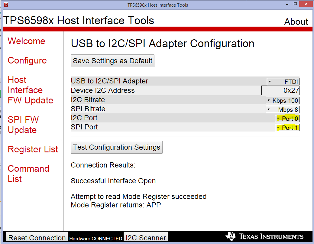

The Application Customization Tool can't seem to communicate with the TPS65981 via the FTDI board.  From observations using a scope it seems that the tool is using the wrong port on the FTDI chip for SPI and I2C communication.  When I look at the serial clock pins it looks like I2C clock is on the SPI clock pin and vice-versa.
When I run the TPS6598x Host Utilities GUI Version 2.3 which I understand is out of date, I have to swap the default ports used for I2C and SPI before it succeeds:
So, this leads me to believe that for whatever reason the wrong ports on the FTDI device are being used for I2C and SPI communication.  Is there a way with the Application Customization Tool to select the FTDI port used for SPI/I2C communication as can be done in the TPS6598x Host Utilities GUI Version 2.3?

  • Thanks for the response.  I wasn't questioning the HW connection, but rather the ports that end up getting used by the Application Customization Tool for the I2C bus and the SPI bus.
    I am using the "TPS6598x Application Customization Tool version 4.03" which is the latest.  The FTDI driver is what was installed with the tool and the FTDI version is 2.12.28.0.
    Yes I did an I2C sweep and it fails.  It you look at the user guide page 19, J8, when I do the sweep I see a 400 KHZ clock with 9 clock pulses (seems like a typical I2C clock to me) coming out of pin J8 pin 13 which connects through a resistor to the F_SPI_CLK net.  When I run the "TPS6598x Host Utilities GUI Version 2.3" I have to change the ports used for the I2C and SPI bus before the test succeeds and then the I2C SCL/SDA signals are on the right pins.  The fact that I have to reverse the ports to get the I2C SCL on the right pin with the Host Utilities tells me that there is something swapped between the apps and the driver.
    It looks to me like for whatever reason, maybe between the driver and the app, the wrong ports are used by the tools.  I can see with a scope where the I2C SCL is when I run the I2C sweep and it ends up on the SPI_CLK pin.  It is a pretty simple thing for me to see with a scope.  What I want to know is whether or not I can swap ports used by the "TPS6598x Application Customization Tool version 4.03" like I can with the ""TPS6598x Host Utilities GUI Version 2.3".

  • Hey Eric,
    Thanks.  From what I can tell there seems to be some variability to how those ports get set up by the FTDI driver.  So Saturday and yesterday I couldn't get the customization tool to communicate over SPI (the evm recovery  firmware download would fail during verification), and the various I2C commands wouldn't work like scanning the I2C bus, manually setting the I2C address to 0x27 and performing the test I2C read.  But yesterday, I got my hands on the second EVM we have in house, connected it and I was able to download the EVM firmware and use the I2C bus for debug.  I did notice in the Windows device manager that different com ports were created which is typical when FTDI devices are plugged in to different ports or a different FTDI device is connected to the same port.  Now today I was able to communicate with both of the EVMs.  So, like I said it just seems like their is some variability that happens when connecting these to different USB ports and how the FTDI driver assigns them.  But that is just a guess for now.
