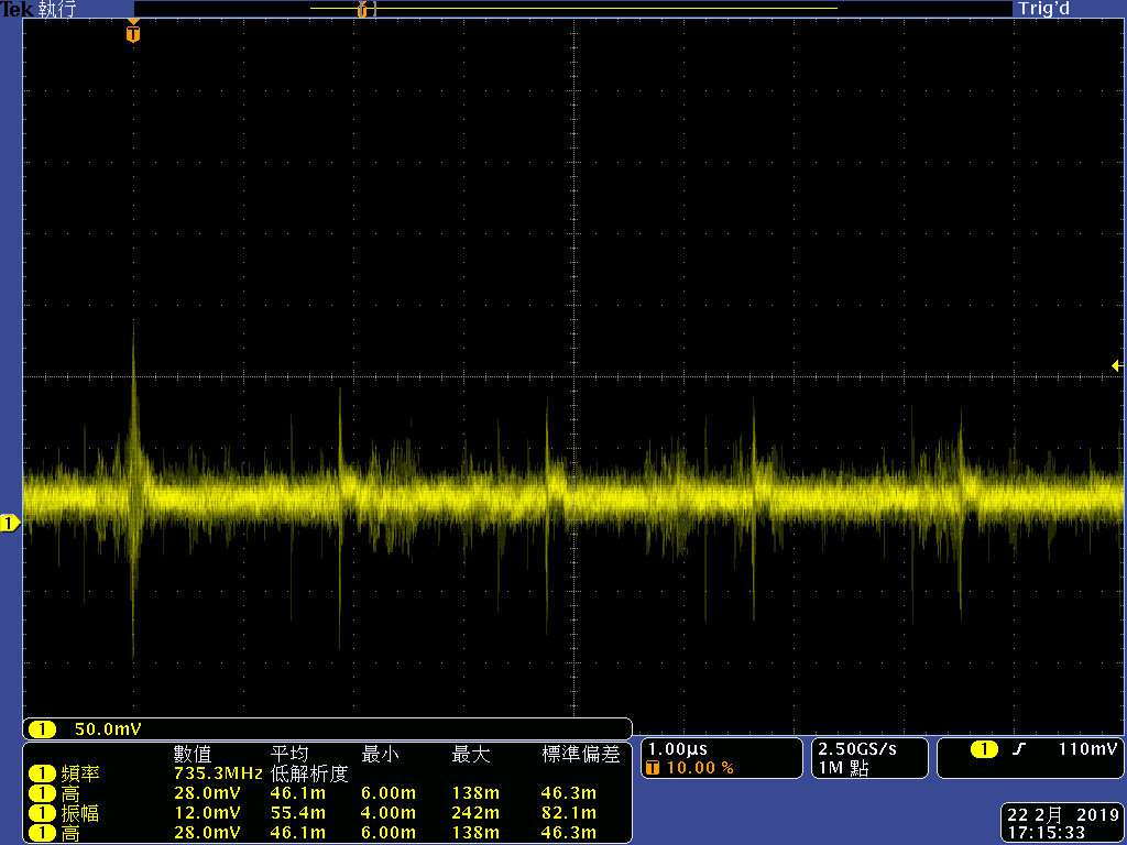

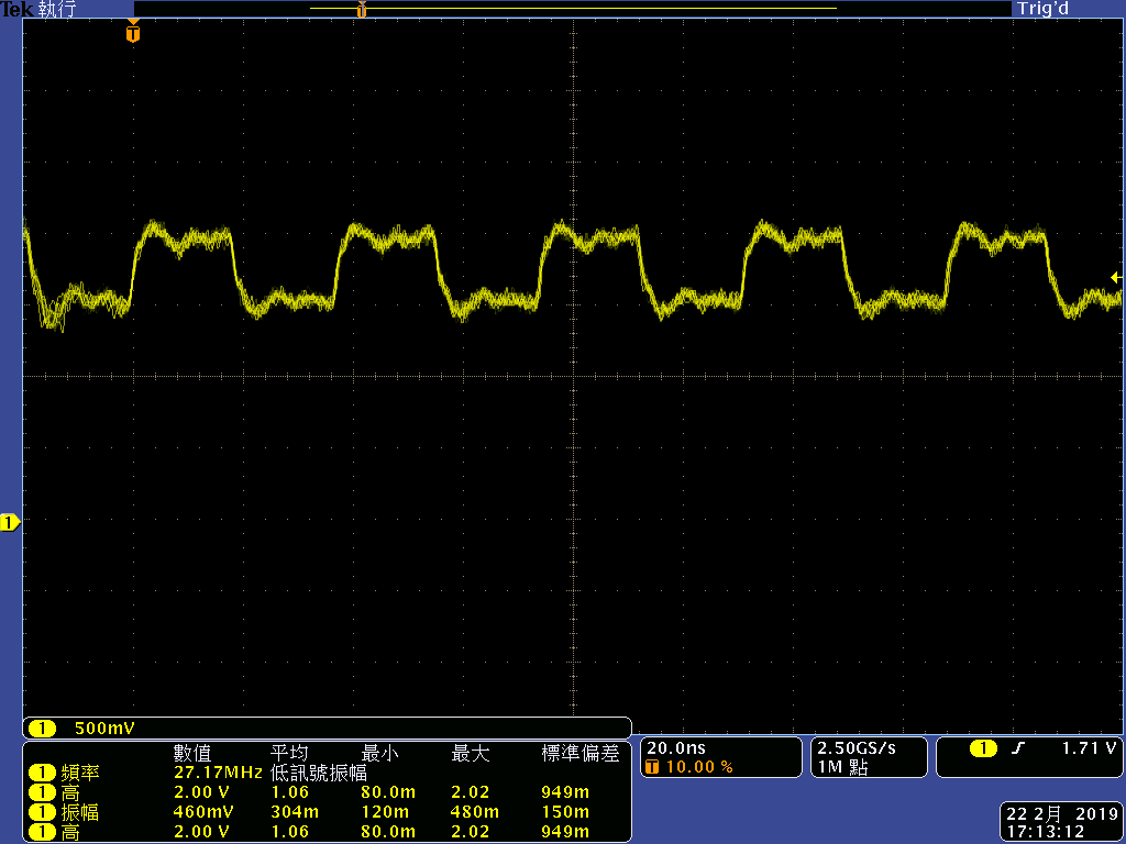

    Attached this measurement waveform.
    Input of LMK03328
    Output of LMK03328

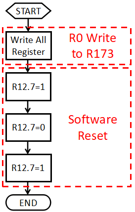

  • Hi Ben,
    I was able to successfully generate an output using these settings.
    You may need to issue a software reset by toggling the RESETN_SW bit.
    To debug it, first check the STATUS outputs. STATUS0 is configured to SECREF Loss of Signal (LOS), and STATUS1 is configured to PLL1 Loss of Lock (LOL), with both active high. If SECREF is detected and PLL1 is locked, then both STATUS pins should output logic 0.
    Kind regards,
    Lane
  • Hello Lane & Alan,
    The customer's reset control process is as below. Is there any wrong about it?
