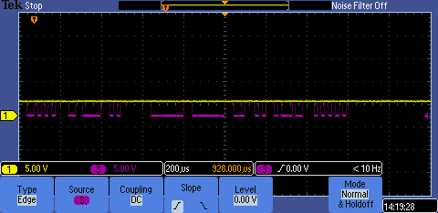

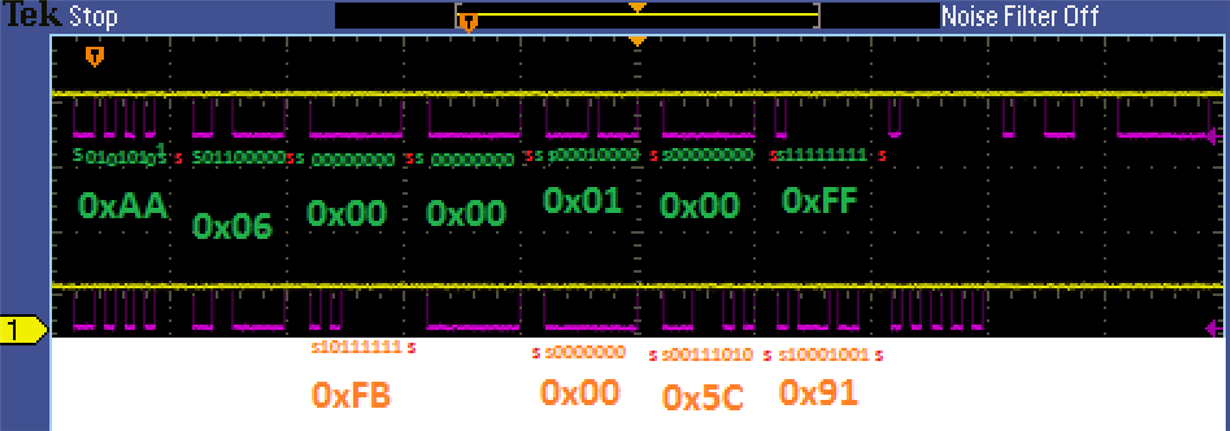

  • Hello Bobby,
    Attaching the snap for Full frame under normal operation with ambient temperature of ~25Deg C  and missing frame under ambient temp. at ~60 Deg C.
    For "What happens if you try to send more data? Does TXC still transmit or does it only mess up the ending bits of data?"
    Since the QUAD UART IC is mounted on board, I am not sure how to verify this as there are no provision to manually control the data to be send.

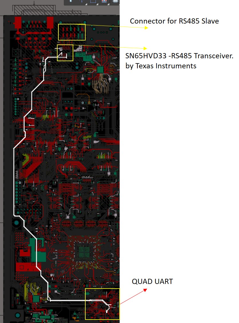

  • Hello Boby,
    Attaching the snap of the PCB layout which shows the position of UART and track layout highlighted.

  • Hey Chitransh,
    Just to be clear, the values I specified in orange are expected values, correct? What you are concerned about is that you are missing a byte of data towards the end of the bottom waveform correct?
    Is the code between the top waveform and bottom waveform any different?
    If you add some delays in your parallel write sequences (Make IOW stay lower for a little longer or add some delay between instructions), will the last few bytes appear?
    -Bobby
  • Bobby,
    The Green values are expected values.
    Orange ones appear when the communication is lost.
    Per our design the 8-bit data bus for the QUAD UART is shared by another peripheral and there appears to be a hardware issue of signal reflection at higher temperature.
    when the bus was isolated the problem of communication appears to be solved.
