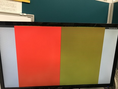

  • Hi Zoe,
    Thanks for your reply, customer used ovt_1280_1080_30fps_REMOTE.py and generate a pattern successfully.
    But customer want to see the real image that is captured from OV10640 image sensor. Do yoy have any .py file which can initial OV10640 imager?
    To display the imager data, all you need to do is remove the line that enables pat gen on the sensor:
    board.WriteI2C(sensorAlias,0x31, [0x29,0x80]) # patgen
    If you remove this line and then run the configuration script, it will use the data captured by the imager. Keep in mind that there is no lens on the image sensor so it is not expected that the observed data will be in focus.
    Zoe
  • Hi Zoe,
    Below picture is pattern generated from OV10640 , serializer is 953, deserializer is 960, is this color right? if no, what's the correct image?
  • Hi Leo,
    With the imager pat gen on, we are expecting to see 8 color bars, not 2 as in your image.
    One thing to note is that the imager is set up to send RAW12 data. Is that what the processor is expecting?
    Can you share the configuration for the 960 and the 953?
    Zoe
  • Hi Zoe,
    Here is the configuration for 953, 960, same with ALP script file

    gst-launch-1.0 v4l2src device=/dev/video0 ! 'video/x-raw,format=(string)YUY2,width=640,height=480,framerate=(fraction)30/1' ! kmssink
    The format that Processor can receive is YUY2,ARGB,BGR,NV12,RGB16, now we use YUY2 640,480.
    We have try to use other receive format and resolution, still can't see the 8 color bar on processor.
    Do you have any idea for this issue?
  • Hi Leo,
    The image sensor is configured to output a 1280x1080 image in the RAW12 format. This doesn't seem to be compatible with the options available on your processor. You could reach out to OmniVision to see if there is a configuration that is compatible with the processor requirements, but looking at the OV10640 datasheet, the formats you mentioned don't seem to be available.
    You can also test the 953->954->processor->display portion of the system using the internal pattern generator on the 953. The internal pattern generator allows you to specify the data type, # of colors, image resolution, etc. Please refer to section 7.6 of the 953 datasheet for configuration details.
    Zoe
