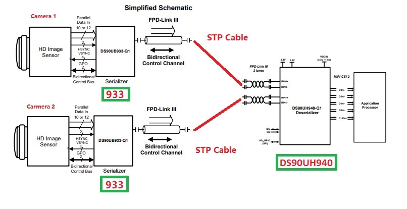

My customer want to use 2 pieces DS90UB933-Q1 to get 2 cameras input (considering the camera can be supported by UB933), output is STP cable, then using STP cable to transmit the data to one DS90UH940-Q1, to get 2 CSI2 output for the processor. The topology is as below.
As I don't have enough experience on this topology, can you help me on answering whether this topology will work? Any reliability concerns on this?
