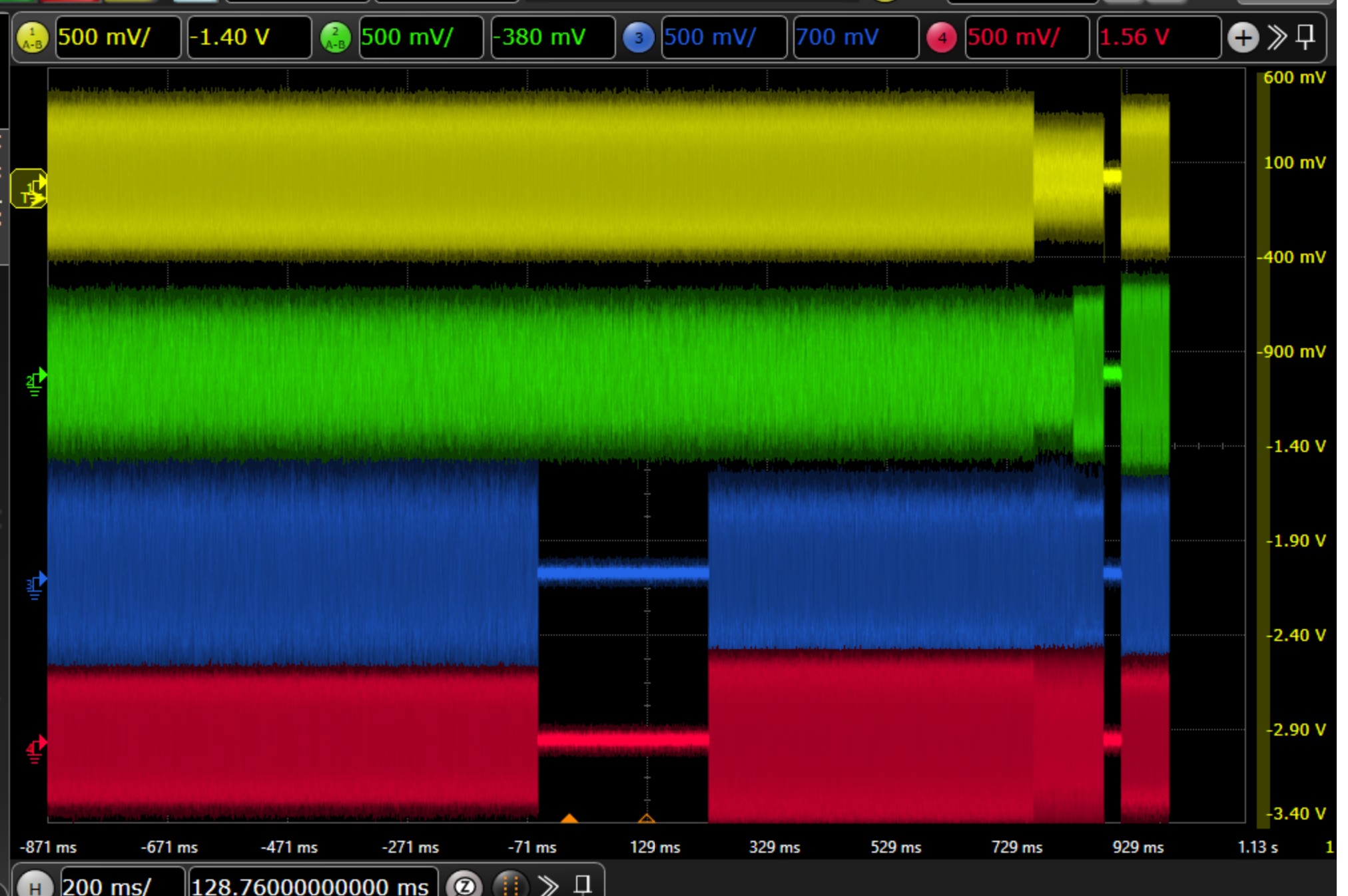

    Can you probe the input of TMDS181 and see if there is no loss of signal when data rate changes?
    David
  • David,
    I am not sure "when data rate changes" exactly, but there does not seem to be, looking at the input signals.
    See the snapshot attached. From the top, we have CLK_IN, Data_IN, Data_Out, CLK Out
    Note that when HPD deasserts, we see the Output pauses, yet the Input continues until just before the second pause
    There is also that curious period where input clk and data appear to be changing, but reverts back after the pause
    Any thought?
    -jj
