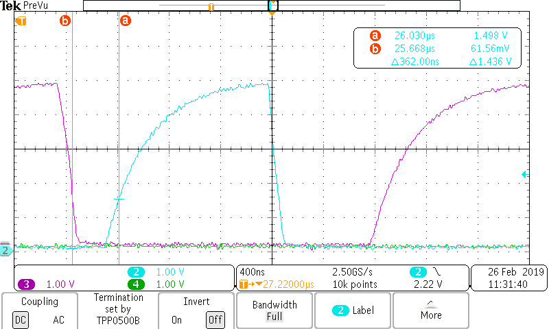

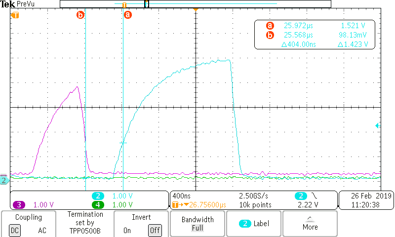

  • Hey Hirotaka-san,
    I did testing with 400kHz on one unit. I found that the device was responsive and worked correctly.
    I check the data set up time on the device to make sure it is I2C compliant (this is where I would expect the device may not meet I2C standard)
    I found the data set up time at 400kHz for one unit to be ~400ns for a write during the ACK and ~360ns for a read ACK. The I2C requirement is 100ns minimum so the data set up time for this device looks to be I2C compliant.
    You can see the waveform above. The top one is the write ACK and the second is the read ACK. Purple is SDA and Blue is SCL.
    I'll have to get back to you on the 'latched input signal' question later.
    -Bobby

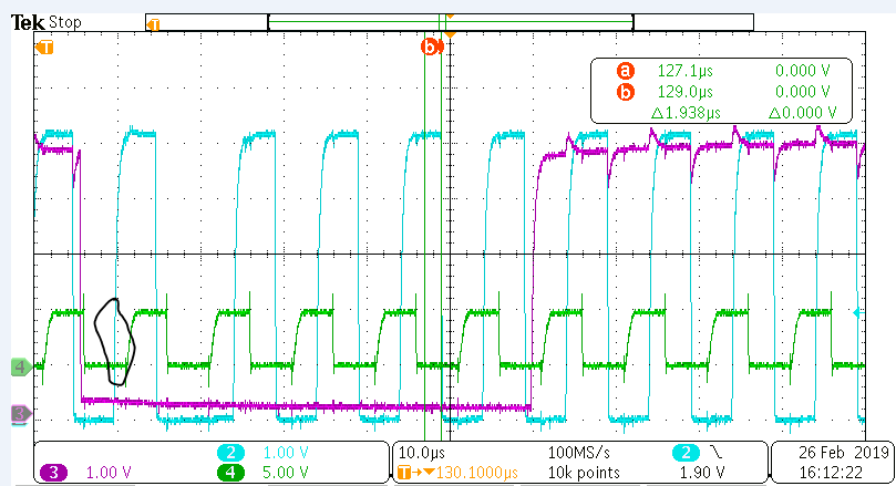

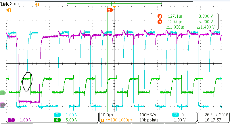

  • Hey Hirotaka-san,
    Next 2 images ports p4 to p7 are shorted together and a waveform is fed into it.
    About the input:
    I marked in black where I believe the data is clocked in. Blue is SCL and purple is SDA. Green is a waveform generator (note the voltage scale is actually 5V).
    I did testing on this multiple times: here is one where 0xFF is found:
    From this I believe the 9th clock cycle of the rising edge is where data is clocked into the flip flops.
    -Bobby
