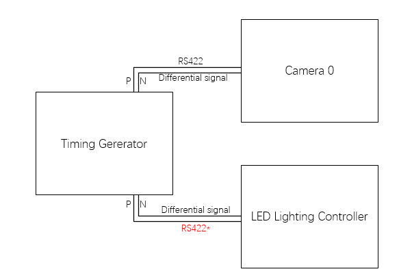

    Application Strategy as follow:
    1: The timing generator is designed with an FPGA by our company, and LED Controller is produced by other manufacturers.
    2: The output channel of the Timing Generator needs to be arbitrarily switchable.

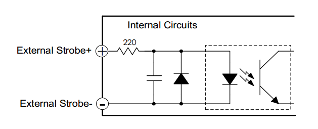

    3: In the datasheet of LED Lighting Controller, I haven`t found out what level standard of the input signal. I have consulted the technical engineer of the manufacturer and they told me that the level standard of the input signal is in accordance with RS422, but I found a description of the input signal in the datasheet (input voltage range is 3.3V-5V, input current Is 20mA) . So we're getting confused for that.
    LED Controller input block diagram is shown follow:
    So I don't know how to design the output of the timing generator.
    Penn
  • Penn,
    Thanks for the clarifications - this is very helpful.
    It looks like the LED controller input was designed to accept a 3.3-V or 5-V input on External Strobe+ (with External Strobe- grounded) and then uses the 220-Ohm resistor to limit the forward current through the opto-coupler to <20 mA.
    It will probably still work when driven by an RS-422 driver (especially if the input was specified to accept RS-422 signals), but the voltage between External Strobe+ and External Strobe- may not meet the 3.3 V minimum requirement. (A smaller voltage here would make the forward current smaller, meaning that the LED is dimmer and the photo-transistor may not turn on as strongly.)
    I would confirm this operating with the manufacturer if possible. Right now it appears that there is an inconsistency in the input specification in requiring a larger voltage than the RS-422 standard generally supports.
    Max
  • Hi Max,
    After reading your reply, I`m more certain that the LED controller`s input does not meet any common differential level standard.
    As you said: "an inconsistency in the input specification in requiring a larger voltage than the RS-422 standard".
    So I will use the output signal of RS422 for system testing, and then choose a more appropriate strategy in the system design to ensure that the circuit can run normally.
