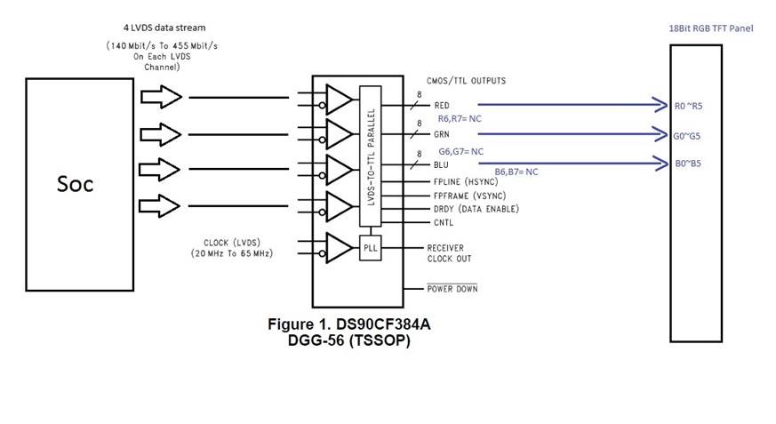

Customer of mine intend to use  DS90CF384A to convert 18bit RGB TFT panel, Can this be done or I should consider DS90CF364A or DS90CF364 ?
Please refer below circuit connection for your reference.
    Any of the 364A, 364, 384A will work. On the 384A you will just not have any toggling on ROUT21-ROUT27.
    If you use the 364, 364A the package foot print is smaller than the 384A; 56 TSSOP vs 48 TSSOP.
    If using the 384A, 364A the PCLK output is 50% duty cycle vs. the non "A" version
