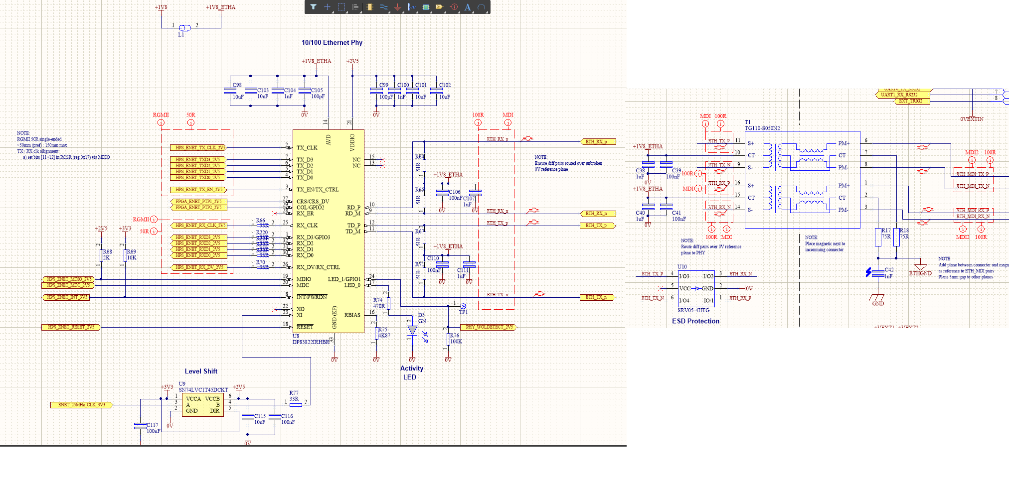

I've got a DP83822I on a board with a Cyclone V (RGMII) - in U-BOOT its failing to auto-negotiate (the Auto-Negotiation Complete bit in reg 0x0001 is never getting set). I'm seeing reg 0x0005 updating with Link Partner information when the board is either connected to a PC, connected with an external loop-back on the RJ45 or configured for analogue loop-back with the BIST register - so it looks like somethings happening. Can you suggest what I need to look at - its not in reset and its got a 25MHz clock. From a similar post these are the registers that were requested:

    Can you also share the schematics?
    -Regards
    Aniruddha
  • Hi Aniruddha,
    Please find attached - nothing is strapped - I'm MDIOing all configuration
    Dave

  • Hi David,
    Our apologies for late response. I looked at schematics and magentics connections, external terminations and they looks ok.
    Also, register 0x04 and register 0x05 contents ( Auto Nego value of DUT and Link Partner are looking ) . Ok. I need to get the register dumps from 0x00 to 0x1F.
    You mention you are performing the configuration from the MDIO/MDC interface. Are you triggering the soft reset after the last configuration ? Can you share the configuration you are programming thru MDIO/MDC ?
    Also, on 0x467 and 0x468: These provides the mode particular strap is programed. However these registers are in extended register space and needs special mechansim to read the content. Procedure is defined in datasheet. Please check you are using the same procedure and values of these  register shared is correct.
    Geet
