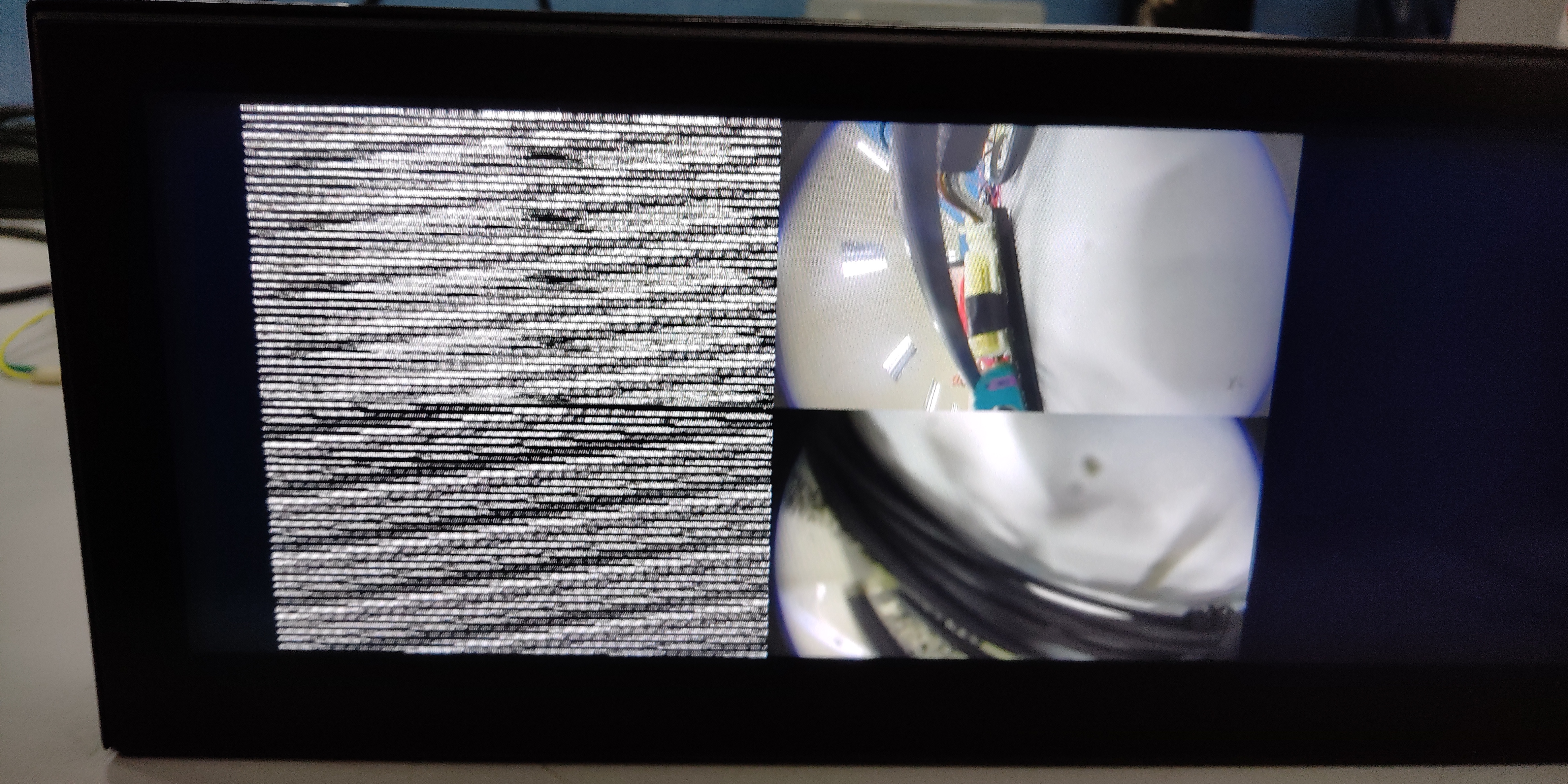

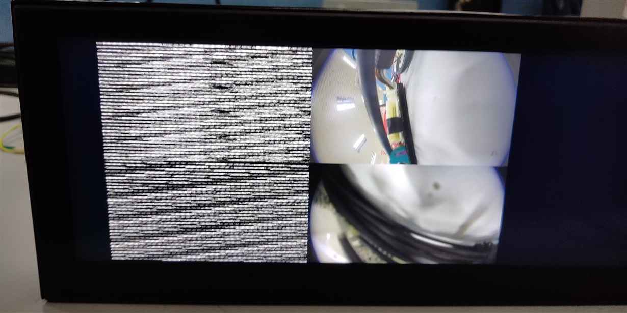

I have some questions about the pattern generator.
I have read section 8.5.6.1 and used the example, I changed the first line of code to enable CSI1,WriteI2C(0x32,0x01)-->WriteI2C(0x32,0x12), but it displays the same as before.
Here is the display:
How can I get all four lanes into color bar mode without using CSI Replicate Mode(0x21)?
Tzung

  • Vishy,
    It can work.
    Only if I use CSI Replicate Mode(board.WriteReg(0x21, 0x80) # Enable CSI Replicate Mode), can I put all four lanes into the color bar Mode?
    Tzung
  • Tzung,
    The CSI_REPLICATE bit is to send the CSI TX port 0 pattern also on CSI TX Port 1. Can you describe your setup? Lane count is selected in register 0x33. Have you set that to 4 lanes?
    Vishy
  • Vishy,
    I set the register 0x33 to 0x03.
    Maybe I misunderstood, I mean, is there a way to make csitx port 1 into the color bar without setting the CSI_REPLICATE bit,in other words, can I set the csi tx port 1 and csi tx port 0 display color bar respectively?
    Tzung
  • Tzung,
    I understand now. Yes, when you using Patgen, you can use only CSI replicate bit. When you have FPD RX port active then you can use Register 0x20 and map RX port data to CSI-2 TX Port 0 or CSI-2 TX Port 1.
    Vishy
  • Vishy,
    Thank you very much.
    Ztung
