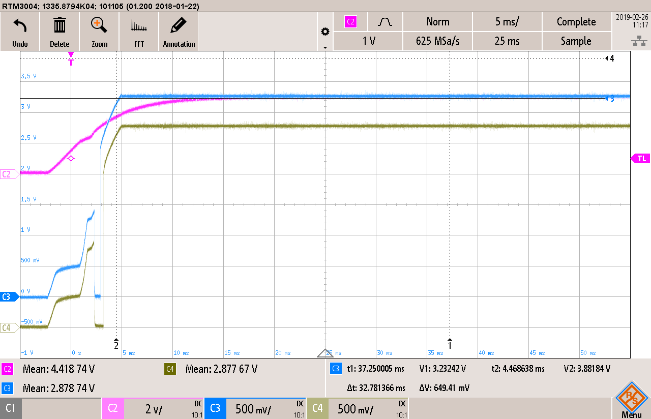

I notice that during a clean startup (5-10 milliseconds) the receiver outputs dip low for 1-2 milliseconds before reverting to default-Hi status.

    Please send a scope picture of the power-up window and the outputs going low.  I suspect the supply voltage has not yet reached the recommended operating range.

    Attached are two scopes.
                   SCR50 shows the supply rail powering up (3.3V; “C4”); C2 is the a 5V rail used for triggering the scope. The 3V3 rail power-up takes about 4 milliseconds.
    SCR51 shows the same 5V rail for triggering, and two different DS90LV032A receivers’ R0 pins. The “+” and “–“ differential inputs are not connected, but terminated with 100 ohms locally.
    We do not have any external biasing as yet.
    Ro connects to a pull-up resistor that powers the base of an NPN – when the Ro is active (low) it pulls down the base and disables the NPN. Ro is expected to be either Hi-Z or default-High during startup, allowing the pull-up to dominate.

  • Hi,j
    It looks like something in the circuit is already starting to load the circuit at VDD = 500mV.

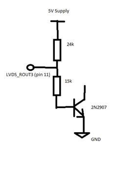

    Can you send the schematic so we can have a better look at the components.

  • Hi Yaser,
    Apologies for the delay.
    The load on the LVDS output is as follows. Note that in this power-up scenario the 5V is also ramping up from zero. Steady-state bias if the LVDS IC is hi-Z should be 2.4V.
    Thanks.
    The behavior of output when Vcc is outside the recommended range cannot be guaranteed. So, unfortunately, I am really not sure how consistent this behavior would be. Have you tried to observe the behavior when the output is not connected to anything?
