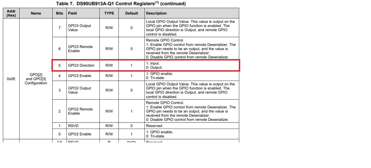

Dear Sir,
If I would DS90UB913A_ GPIO[3] to do a INPUT signal, setting Bits-5=1
How to read GPIO3 input signal data ? can read at DS90UB914A GPIO[3] ?
Thanks!
