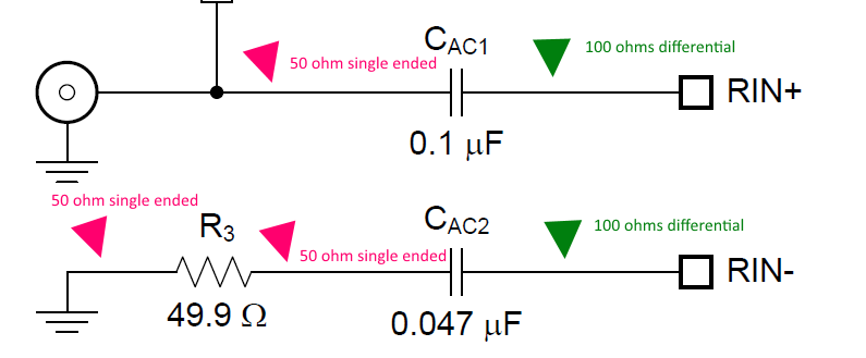

According to the Datasheet of DS90UB954's Page 130.
is that means trace RIN+/RIN- between AC-coupling caps and IC should be 100-ohms  differential ?
then trace RIN+ from AC-coupling cap to connector & trace RIN- from AC-coupling cap to 49.9 ohms ,GND should be 50 single-ended ?
