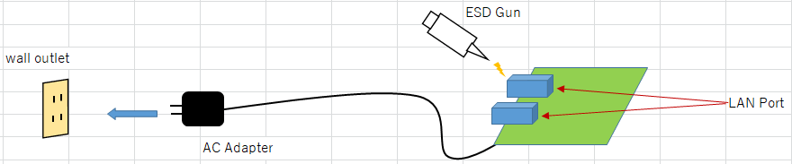

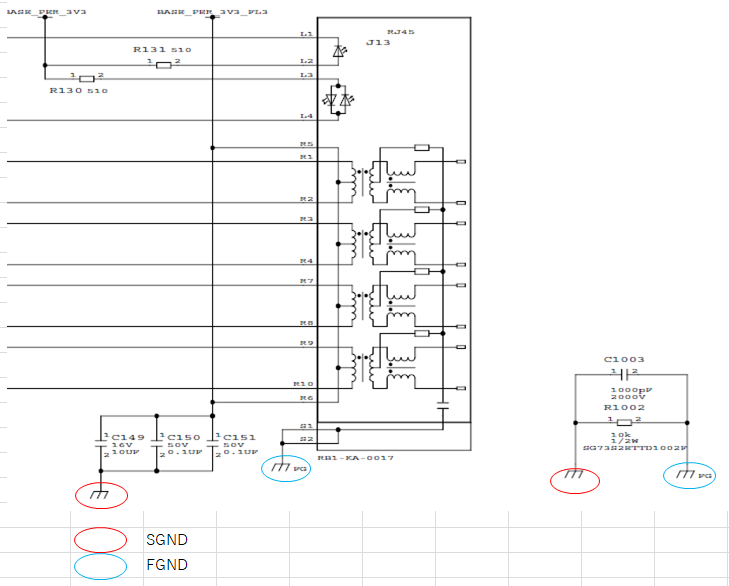

Is there recommended ESD protection IC for reduce GND bounce?
By the way, interface is Ethernet,
ESD source ⇒ Connector chassis ⇒ GND
(Chassis is single phase and 2-line)
Satoshi
In this Ethernet application are you talking about the primary side of the transformer?
