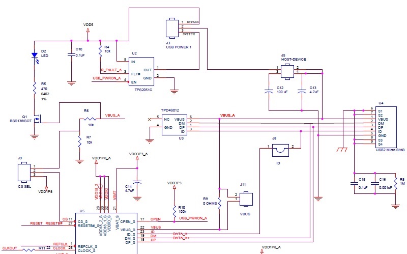

My TUSB1210 is setup as a Host PHY transceiver, as shown on data sheet page 48. It is connected to a USB Device. VBAT (3.3V) and VDDIO (1.8V) are applied.
I have the option of connecting 5V directly to VBUS or I can use TUSB1210 CPEN pin to enable a VBUS switch that will pass 5V to VBUS. VBUS is connected to TUSB1210 VBUS pin and VBUS pin of USB port.
My CPEN pin has a 100k ohm pullup resistor to 3.3V. This is also what is shown in the TUSB1210 evaluation schematic, see attached picture below.
I would like to detect when a Device is connected to the USB port.
My idea is as follows:
Write to VENDOR_SPECIFIC3 register (0x85) bit 4 CPEN_ODOS with a 1 to place CPEN pad in OD (Open Drain) or OS (Open Source) mode.
Then use VENDOR_SPECIFIC3 register (0x85) bit 5 CPEN_OD, already reset to a value of 0, to use CPEN pad as OS (Open Source).
What does active LOW mean in this case? Is this before or after CPEN output pin sees the attached Device?
Can I expect my CPEN pin to be pulled HIGH to enable my VBUS switch when a Device is connected to my USB port?

    DRVVBUS and DRVVBUSEXTERNAL bits (OTG_CTRL register, bits 6 & 5) must be set to 1 in order to to set Pin17 (CPEN). Please notice that the reset value for both registers is 0.

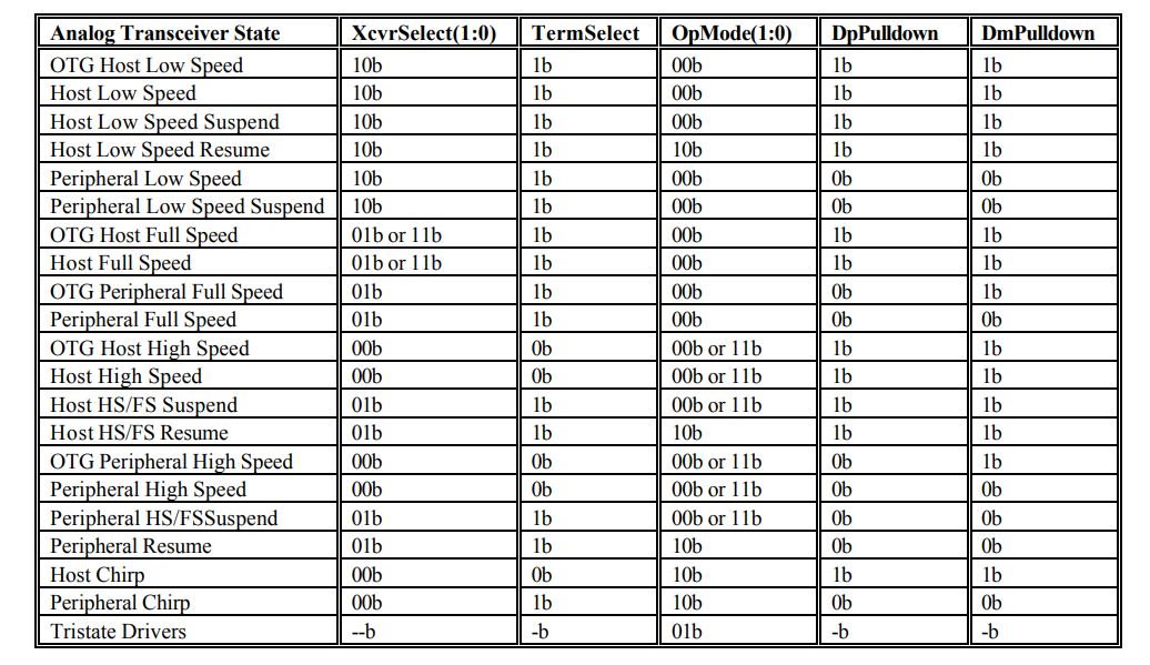

    You mentioned previously "The 1.5k pulldown on the host side of TUSB1210 is only used between TUSB1210 and hub."
    1 - Where do I pull in this 1.5k ohm pulldown on the TUSB1210? Is this an internal TUSB1210 resistor?
    2 - When would the TERMSELECT 1.5k ohm pullup get pulled in from the FUNC_CTRL register?
    3 - By default, the OTG_CTRL register DMPULLDOWN and DPPULLDOWN are set to 1, meaning pull-down resistors connected to D- and D+, respectively. Under what circumstance would this resistors not be connected to D+ and/or D-?

    I think the 1.5k pulldown is a type, it should be 15k pulldown.
    Please see this table, this table summarizes different USB bus condition and answers your question 2 and 3.

    OK, so you said that the 1.5k ohm pulldown is a typo and s/b 15k ohm.
    Where did you find the Table that summarizes the different USB bus conditions?
    Thanks, Roland
  • Roland
    This was covered as part of the ULPI spec: www.sparkfun.com/.../ULPI_v1_1.pdf, Table 41.
    David
  • David,
    Yes, Table 41 , page 82, of UTMI+ (ULPI) spec shows the table of interest.
