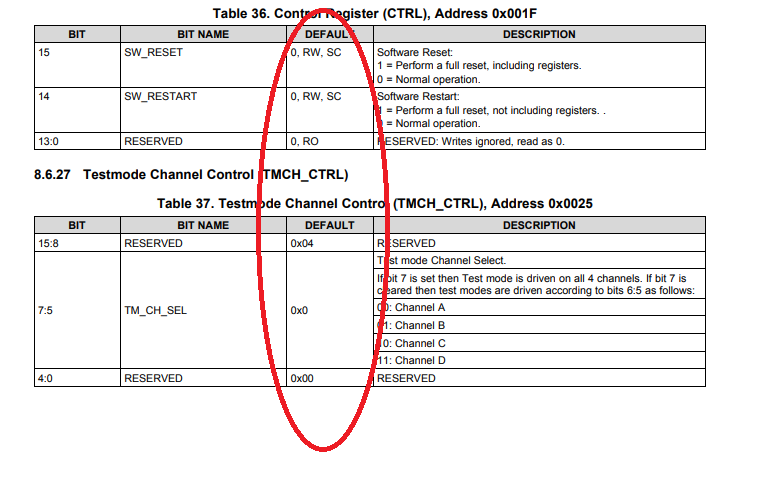

Part Number: DP83867IR
Hi Sirs,
Sorry to bother you.
May i know how get 4 pairs to send out 001 = Test Mode 1 - Transmit Waveform Test this pattern?
At present, only the pair port A can do it.
Thanks!!

Hi Sirs,
Thanks for your reply.
Dear Eric
We tried Appendix B on your doc, use mii command to control.
mii write 0x05 0x001f 0x8000
mii write 0x05 0x0000 0x0140
mii write 0x05 0x0010 0x5008
mii write 0x05 0x0009 0x3b00
mii write 0x05 0x0025 0x0480
1000 Base Test Mode 1: Reg 0x001F = 0x8000 //reset PHY
Reg 0x0000 = 0x0140 //1000 Base-T Mode
Reg 0x0010 = 0x5008 //forced MDI Mode
Reg 0x0009 = 0x3B00 //Test Mode 1
Reg 0x0025 = 0x0480 //output test mode to all channels Reg 0x01D5 = 0xF508
It's same phenomenon. 0x0025 & 0x01D5 couldn't write! !!
Read 0x0025 is 0
Reg 0x01D5 = 0xF508
So, does Address 0x0025 could be write?
