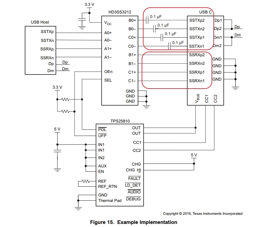

Hello Sirs,
May I know if we follow TPS25810 Fig.15 but HD3SS3212 B0+/- and C0+/- swap  ,  B1+/- and C1+/- swap .
Will tps25810 still could put correct /POL polarity to control HD3SS3212 SEL pin ? This is Motherboard DFP application . TKS !
