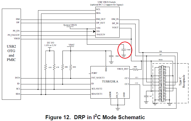

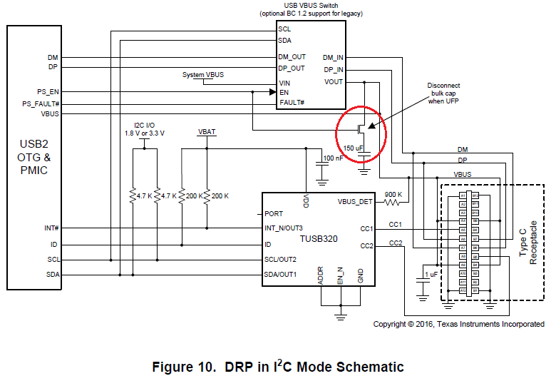

Regarding VBUS capacitor for DRP application, I found the different schematic between TUSB320LAI and TUSB320 as the following.
-TUSB320LAI
-TUSB320
1)
It seems FET that enable/disable 150uF capacitor isn't required for TUSB320LAI if 150uF is set at System VBUS.
Is my understanding correct?
2)
If 1) is correct, is the FET required for TUSB320?
