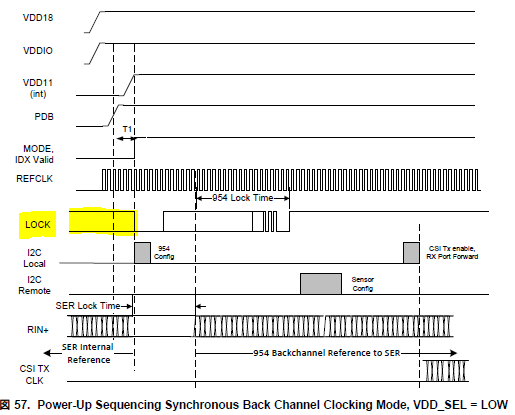

What is the output status of LOCK pin from power on to PDB released.
In the figure below the data sheet, LOCK is undefined before the PDB is released.
Is this Hiz?
Or does it mean that you don't know either active low or active high?
If it is Hiz, I think that it is good to attach a pull-down resistor to LOCK pin.
Is this method correct?

  • Hello Tomoaki,
    1. When PDB is low, LOCK is HIGH-Z and it is ok to place a weak pulldown on LOCK
    2. The time from power on to LOCK action is not well defined because it depends on the system implementation. Please take care that you don't input an GPIO signals to 953 before the power sequence has occurred, otherwise you will violate the abs. max for the pins.

  • Hi Casey-san,
    Thank you for your support.
    GPIOs of 954 are connected with PDB and LOCK of 953.
    Since PDB pin is input, I think that we only have to take care about LOCK.
    By inserting a pull-down resistor on the LOCK output, I think that it will avoid  the 953 absolute maximum rating violation.
    Is this correct?
    How much resistance should I insert if we insert pull-down resister?

  • Hi Tomoaki,
    It is not recommended to add a pull down to the 954 LOCK pin. If your intention is to bring the 954 up after the 953, you can delay the PDB itself on the 954 with a RC network.

  • Hi Tomoaki,
    I looked into this further and it is okay if you add a pull down. We typically bring the LOCK pin out to an LED as an indicator and haven't had an issues with that, so you should be okay.
