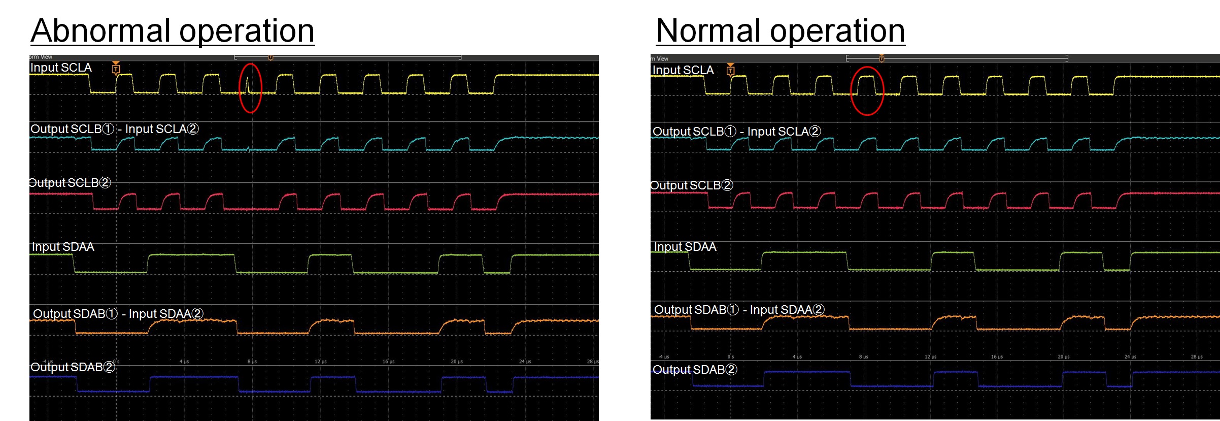

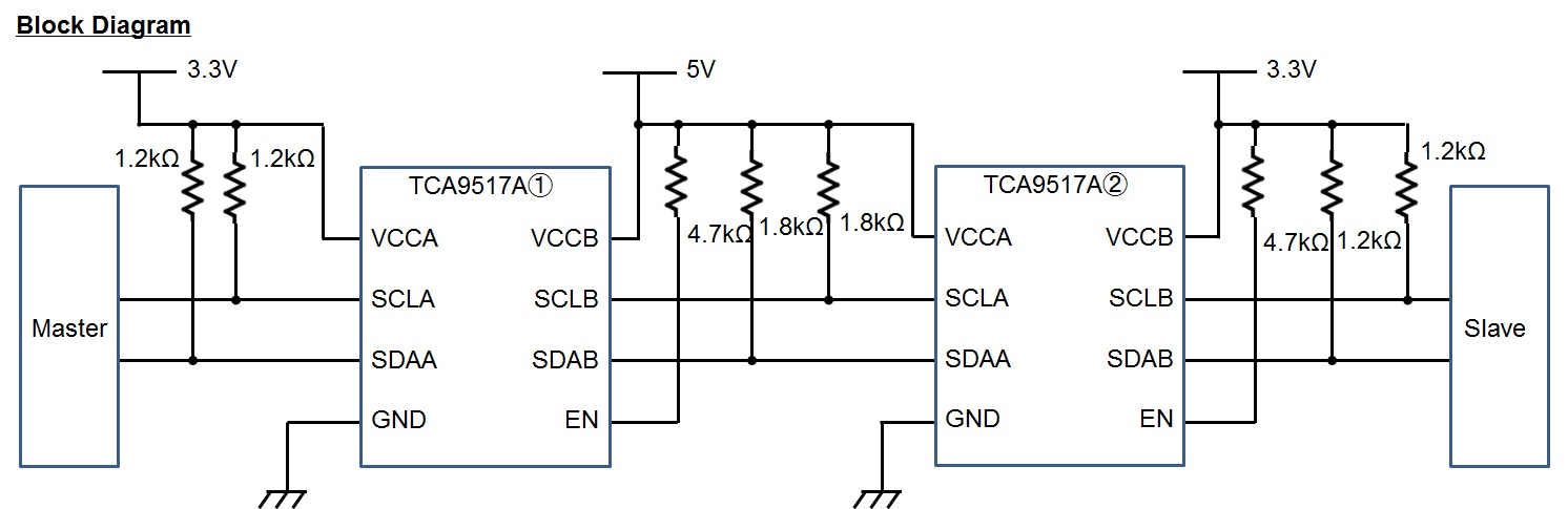

Customers are using the configuration for TCA9517A shown below.

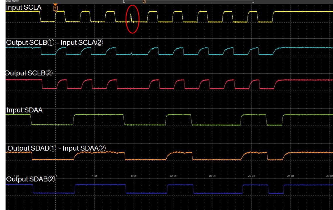

In that case, the waveform is as follows.
Input CLK is not input correctly. There may be a problem on the Master side.
But when using TCA9617B in the same configuration, the waveform was normal.
Do you know the cause? Are the input and output pull-up resistors appropriate?
