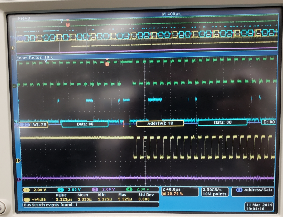

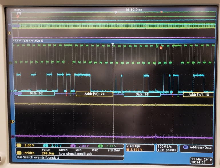

    For the most part the switch works fine, its just that every so often it fails to switch over to the selected bus, as if the command did not complete with a valid stop.  The following photos show a good switch to the selected bus, a good switch away from that bus, and then a failed switch.  We have a workaround, which forces us to retry the switch if we see a non response from the device on the SDx/SCx bus, and that works, I just want some more insight.  You mentioned that you have an updated part that looks like a drop in replacement, and I would assume it is because of design improvements, is one of those improvements because of this type of intermittent?  I will look into the possibility of using the newer part as a better than replacement, but for now I have existing boards populated with the legacy part.
    The top two traces are the SDA and SCL, the trace below that is the SC2  or clock of the selected bus.

    The last image does not seem to indicate a fail case if we are looking at SC2. The data you sent is 0x08 which indicates channel 3 is turned on and all the other channels are turned off. You do not have a probe watching channel 3. Were you able to verify that channel 3 was not active? (if you are trying to communicate through channel 2 then you need to send 0x04h).
    -Bobby

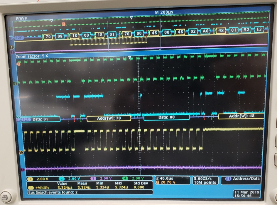

    Attached shows the timing of the stop bit, and yes you are correct it is SC3 i am showing in all three previous photos not SC2 as indicated earlier.  My bad on that, but as you can see in the traces the switch to SC3 and off of it occur correctly, whereas in the last picture it does not switch to SC3.
    Here is the timing of the stop bit, i will look into the stop to start times to see if we are in violation.
  • Just checked the system and we are almost 11us between stop and start... (as you can see from the photo above too)...

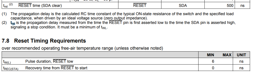

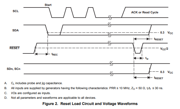

    I'll be setting that up and posting scope shots later today.  Thanks for that tip, when we re-read the data sheet we were puzzled at the Reset timing as there was some ambiguity.  We read it as the reset pulse can be as narrow as 6ns (tw), and that a Stop could be interpreted if SDA went High within 500ns max (trst). Then we read the trec value of  0 ns, and became puzzled as the waveform in the datasheet somewhat obscures what was written (instead of clarifying).
    Can you elaborate on a reset scenario where a 6ns pulse occurred randomly (i.e. from noise), that is, would the chip think a Stop was issued if the SDA was high at the time?

    " when we re-read the data sheet we were puzzled at the Reset timing as there was some ambiguity. ......."
    The reset pin is mainly to get the device back into the default state (all channels turned off) in the event that SDA is latched low (this is called a stuck bus, there a multiple ways for this to happen) while one of the SDA channels is enabled. So the trst parameter you are referring to is the time it takes for the channels to be disabled (the main SDA channel is pulled high if the master is idle because no one else is controlling the bus). So if you hold reset low and released, you would expect that in 500ns the device's channels will all be disabled and communication to TCA9548A would be possible after this (previously it wouldn't be because you had a stuck bus). Essentially, you can use TCA9548A to isolate stuck buses with the reset pin feature.
    "Can you elaborate on a reset scenario where a 6ns pulse occurred randomly (i.e. from noise), that is, would the chip think a Stop was issued if the SDA was high at the time?"
    There could be multiple reasons why a reset pin could dip for a small amount of time. The main culprit I suspect would be crosstalk. If you have a trace that runs parallel to the reset trace either on the same plane or directly on top/below then the copper of the two traces plus the insulator between the two form a parasitic capacitor. With really strong drive strength, you can generate a fast di/dt which could cause current to temporarily flow from one trace to the next through the parasitic capacitance formed by the two traces. The faster the di/dt the greater the effect. You could potentially see your reset signal dip for a small amount of time, the weaker the pull up resistor is on the reset pin, the longer it takes for reset go back to a high state. So if this is the issue, then we would probably need to give the reset pin a stronger pull up resistor. I would also check to see if any signals are driving low (and parallel/cross the reset PCB trace) during the I2C transaction where we see the switch fail to actually switch. Because we see the TCA9548A ACK, I suspect if the issue is reset, it would occur shortly after the ACK.
    "would the chip think a Stop was issued if the SDA was high at the time?"
    Note: The state of the SDA/SCL pins do not matter to the reset pin, the reset pin itself simply resets the state machine and sets the channels to all be disabled like a power on reset/ powercycle.
