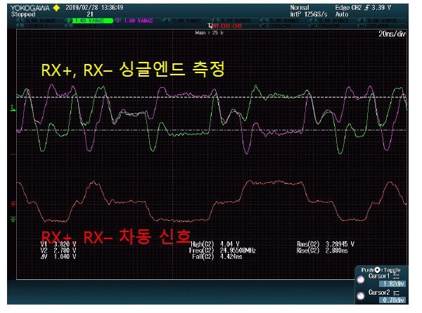

My Customer is using the OSC on the DP83640.
But Crystal OSC is normal, but MEMS OSC is abnormal.
Crystal OSC : ASE-25.000MHZ-LC-T
MEMS OSC : DSC6001CI2A-025.0000
RX waveform of using DSC6001CI2A-025.0000

I attach a MEMS OSC Datasheet.
Can you check if the DSC6001CI2A is applicable?
