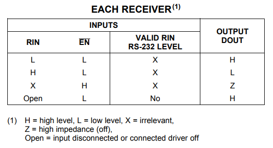

I have questions about FUNCTION TABLE,
(1) When FORCEOFF=L, only Dout became Z. ROUT is no relation.
(2) When EN=H, only Rout is Z. Dout is no relation.
(3) I think FUNCTION TABLES is wrong.
This table describes OUTPUT DOUT, but this is for receiver, it should be OUTPUT ROUT.
In addition, MAX3223 datasheet is OUTPUT ROUT.
