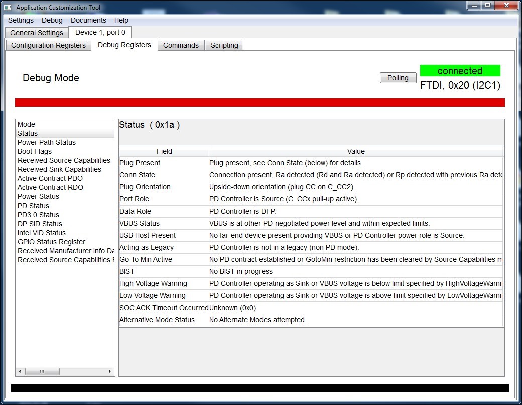

    In the meantime we did a lot of testing with the TPS65987 Power Duo EVM (with the source part of the EVM).
    Intended target application: A docking station with an integrated hub and other USB peripherals. The docking station can be self-powered or powered by a Smartphone (at least S9 or newer models). The USB type C cable shall not needed to be disconnected/reconnected when the powering role changes.
    Test use case:
    S9 is off and connected to the TPS95987 Power Duo EVM (Source Side). The firmware is the Default EVM firmware which has beem flashed using the Application Customization Tool.
    Observations:
    It takes typically several power cycles of the EVM until the S9 starts charging. It seems to be random whether charging starts or not after powering up the EVM.

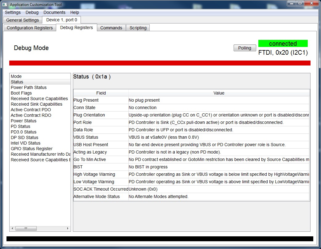

    In case charging does not start, the Status looks like that:
    In case charging starts successfully after powering up the EVM, the status is as following:
    Any ideas why the S9 charging does not start always after powering up the EVM?

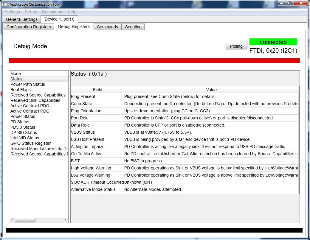

    While the S9 gets charged by the EVM (S9 is a PD compliant sink, EVM is PD source), the EVM power supply gets disconnected.
    Observations:
    After EVM reboot due to the short interruption of VBUS, the EVM switches to Legacy Sink Mode and gets powered by the S9.
    Then the power supply is reconnected to the EVM and the dead battery flag using the appropriate command is cleared.
    The EVM stayes in Legacy Sink Mode which seems to be because the S9 does not communicating any more in PD mode. Ok, this seems to by related to the S9.
    Manually disconnecting and reconnecting the USB type C plug after a while does not solve the problem, because the EVM seems to stay forever in Legacy Sink Mode unless the EVM is also power cycled.

    Best regards
      Roland
  • Hi Roland,
    I believe I must have glanced over this from the original description
    "As described in an earlier post, the problem arises when the power of the EVM get disconnected and the TPS65981 should change to PD compliant sink after VBUS is powered by the S9 phone (there is a short interruption of power after disconnecting the EVM power supply until the S9 delivers VBUS power)."
    Are you using the default project file that is loaded on the TPS65987D Power Duo EVM? If so, then that may explain the failure as the source board on the power duo EVM is not programmed to ever act as a sink device. If you would like for this functionality, then you will need to re-flash the board with a new project file, but you will also lose the functionality of the buttons if this is done.
    If you are not using the default template but instead one you have programmed yourself, could you share that with me so that I may take a look?
