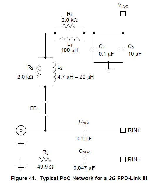

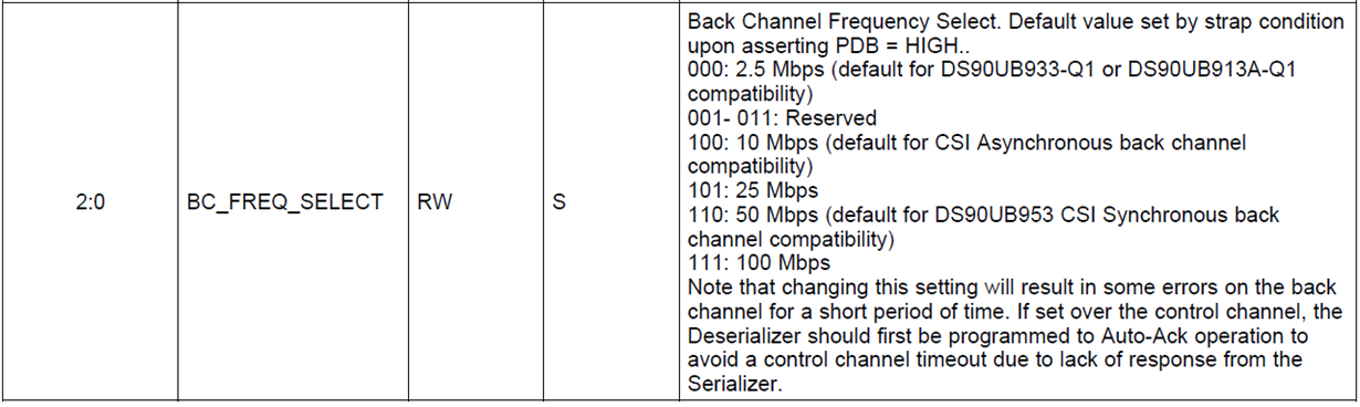

  • Hi Dennis,
    Could you verify the following to make sure your system is set up correctly on the DS90UB954-Q1:
    • Check Mode Pin to make sure it's in RAW mode:
    • Check register 0x58[2:0] to set to 000 for correct back channel frequency:
    • Check AC coupling aps for the RX inputs:
    • Check PoC network:
    Additionally, can you also check registers 0x56 and 0x55 on the 954 for parity errors? If there's no parity errors, and the SerDes system is set up correctly, it's most likely the imager intialization issue. I would advise consulting the imager manufacture about this.

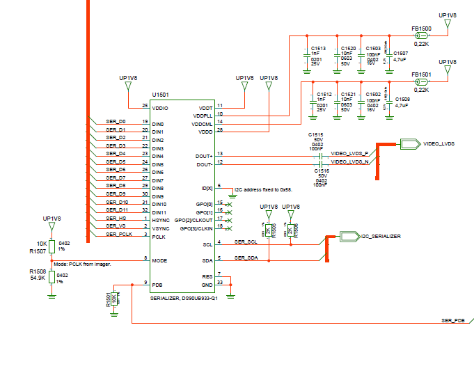

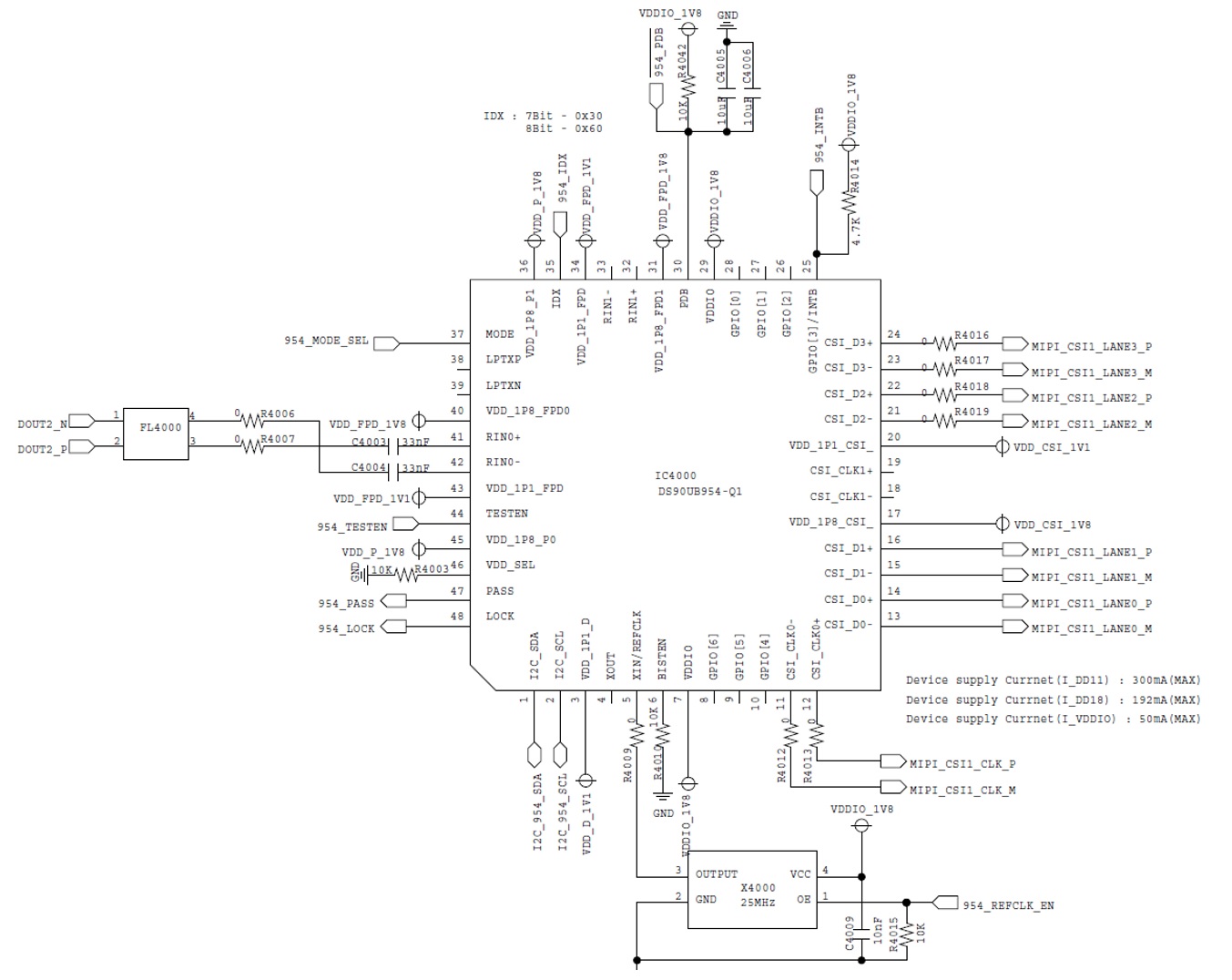

  • 1. as to "check Mode Pin to make sure it's in RAW mode",  the 954 connection is as below:
    there is no information on "954_MODE_SEL". However, when i read our register 0x6D, it is 0x7B, which means "RAW10 Mode/100 MHz" with "Shielded twisted pair (STP) mode".
    2.  register 0x58 has value of 0x58, confirm "0x58[2:0] to set to 000";

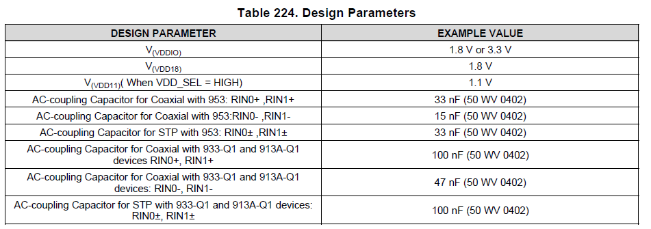

    3. to check AC coupling aps for the RX inputs, i have 933 connection as below, I can see C1515&C1516 with "50V, 0402, 100nF": 1) no sure if "50V" is OK for "50WV" as 954 asks? 2) on 954 connection above, there are another "C4003&C4004" with 33nF, no sure if that looks OK?
    4 as to "Check PoC network", i think camera has its own power, and do not use PoC. but I will confirm with customer;
    5. I checked "registers 0x56 and 0x55" on 954 during the problem, they are both 0;
  • Hi Dennis,
    Could you ask the customer to change the AC caps on the 954 side to 100nF? Other than this everything seems correct.
    I believe the issue is coming from the imager initialization side. You may need to talk to the imager manufacturer about this, or you could also do post processing on the SoC side to remove the last line.
    Jiashow
  • Do you mean to change C4003&C4004 to 100nF? If so, on 933 output side, there are another C1515&C1516 with 100nF, so, it will become two C1515+C4004 and C1516+C4003, and then become to 50nF for every line? Do you think that we need short C4003 and C4004?
  • Hi Dennis,
    Yes. Please change C4003 and C4004 to 100nF. You don't need to short them.
    Jiashow

    Meanwhile, can you please tell what is the FL4000 for? I was told by customer that is "followed the FL4000 filter as the TI's guide". Any documentation for this FL4000 module to be shared?
  • Hi Dennis,
    I'm not sure what FL4000 is. You may need to clarify it with the customer.
    Jiashow

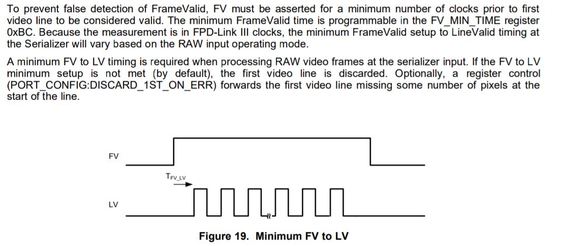

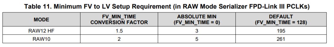

    Meanwhile, I got one useful information from camera provide, that
    When you use a '933 together with a '954 there are restrictions on the time between activation of the VSYNC signal and the activation of the first HSYNC directly after that. If these two flanks come too close, there will not be time enough for the '954 to send out both the (embedded) code for the VSYNC, the HSYNC and the actual data in the beginning of the line. In these cases the first line will be skipped (or under some unclear circumstances only parts of the line, and an error be indicated in some register).
    If the first line is skipped, the last line will be non-existent and maybe that then can cause the purple line.
    I check my result, it IS first line to be missed, which means we likely hit this case.
    Are you aware of this restrictions? do you know anything on 954 side by which we could workaround  this restrictions?
    Dennis

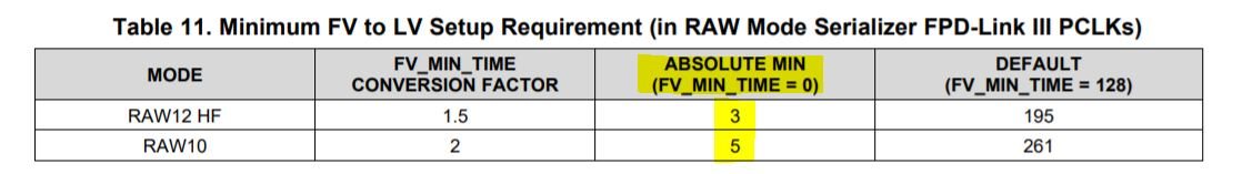

  • Hi Dennis,
    Please check out section 7.4.14 on the datasheet. Here, we discuss the FV and LV requirements:
    Jiashow
  • Hi, Jiashow,
    That looks like exactly what our problem is.
    Given it require "A minimum FV to LV timing is required when processing RAW video frames at the serializer input", if that means that nothing could be done on 954 side to compensate it, such as playing around FV_MIN_TIME or other register(s)?
    Dennis
  • Hi Dennis,
    You could set FV_MIN_TIME (in reg 0xBC) to 0, but this would still require a FV to be high for at least 3 clock periods before LV is asserted in RAW12HF mode (and 5 clock periods for RAW10 mode):
    If this requirement still cannot be met, you would have to fix this from the imager side.
    Jiashow
  • changing FV_MIN_TIME to 0 does not change the problem, I have to ask a fix from the image side. I will keep you updated.
