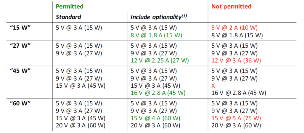

  • Hi Sirs,
    Thanks for your reply.
    I have 2 questions.
    1. After I survey USB PD standard,I got below information.So,standard agreed several power voltages.Could I let power source output only 1 power voltage (9V)?
    2. TPS65987D need 3.3V power.But,my product had no power input before USB type c power source plug in.How to implement this mechanism?
    1. If you were to advertise 9V, you must also advertise 5V/3A to remain compliant.
    2. We consider this a dead-battery condition. If you look through the datasheet, section 8.3.5 explains the dead battery procedure, and table 6 shows the different dead battery behaviors controlled by the ADCIN1 configuration.
